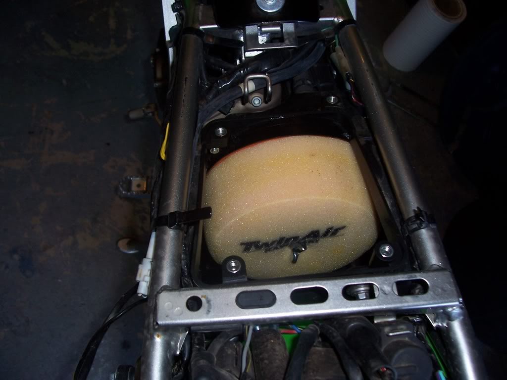

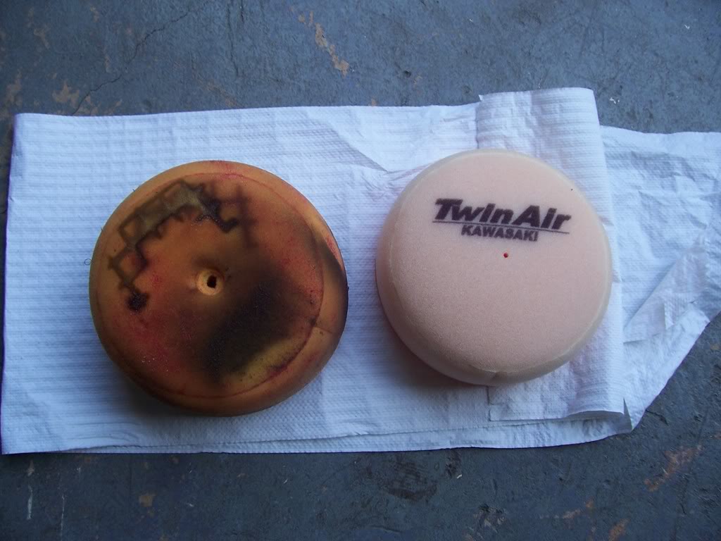

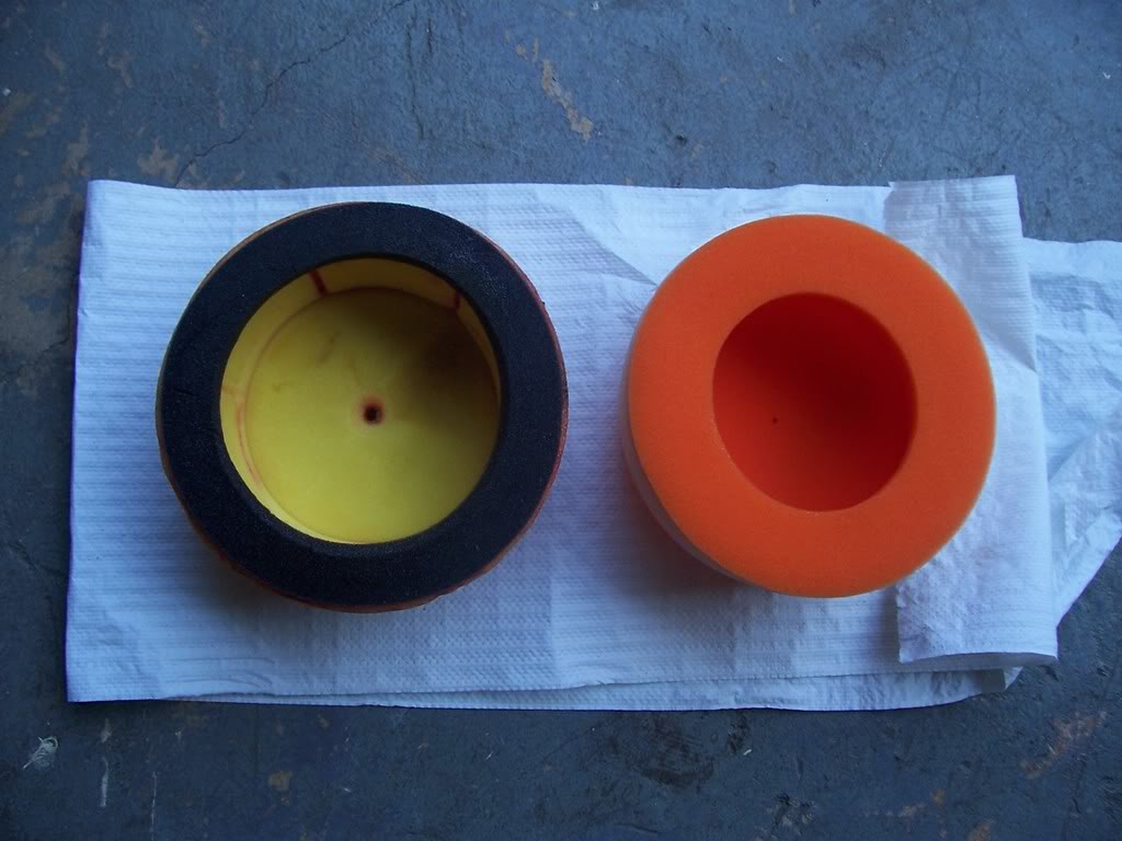

Just installed a Twin Air Filter that I had intended to put in the KDX. The oem part numbers are the same for the KLX250 and the H model KDX200-220's ('95-'06). Take a look at this beauty This might be a good mod for all of you that have re-jetted, added an aftermarket exhaust, modified the air box lid, or all of the above. I'm sure I'm running super lean now as the bike is stock but I'll have to see how she rides.
Mike

Did you oil it? Doesn't look oiled..
I grabbed a Uni. I can't see any difference between one foam filter and another from a performance stand-point.
Yeah I oiled it pretty good. I have a Uni installed by the previous owner in my KDX and was gonna change it out for the Twin Air. But my KDX needs a top end as it's been running the original top end since 2001. So I decided to put the Twin Air in the KLX. After cross-referencing the oem part number I discovered that they are identicle.
I put a Twin Air in my sons CRF150 and it's 'purred' ever since, so I went with the twin for the Kawi. After dealing with these aftermarket filters I can tell you that the oem sponge is utter crap. I can't see how the oem filters breathe at all.
