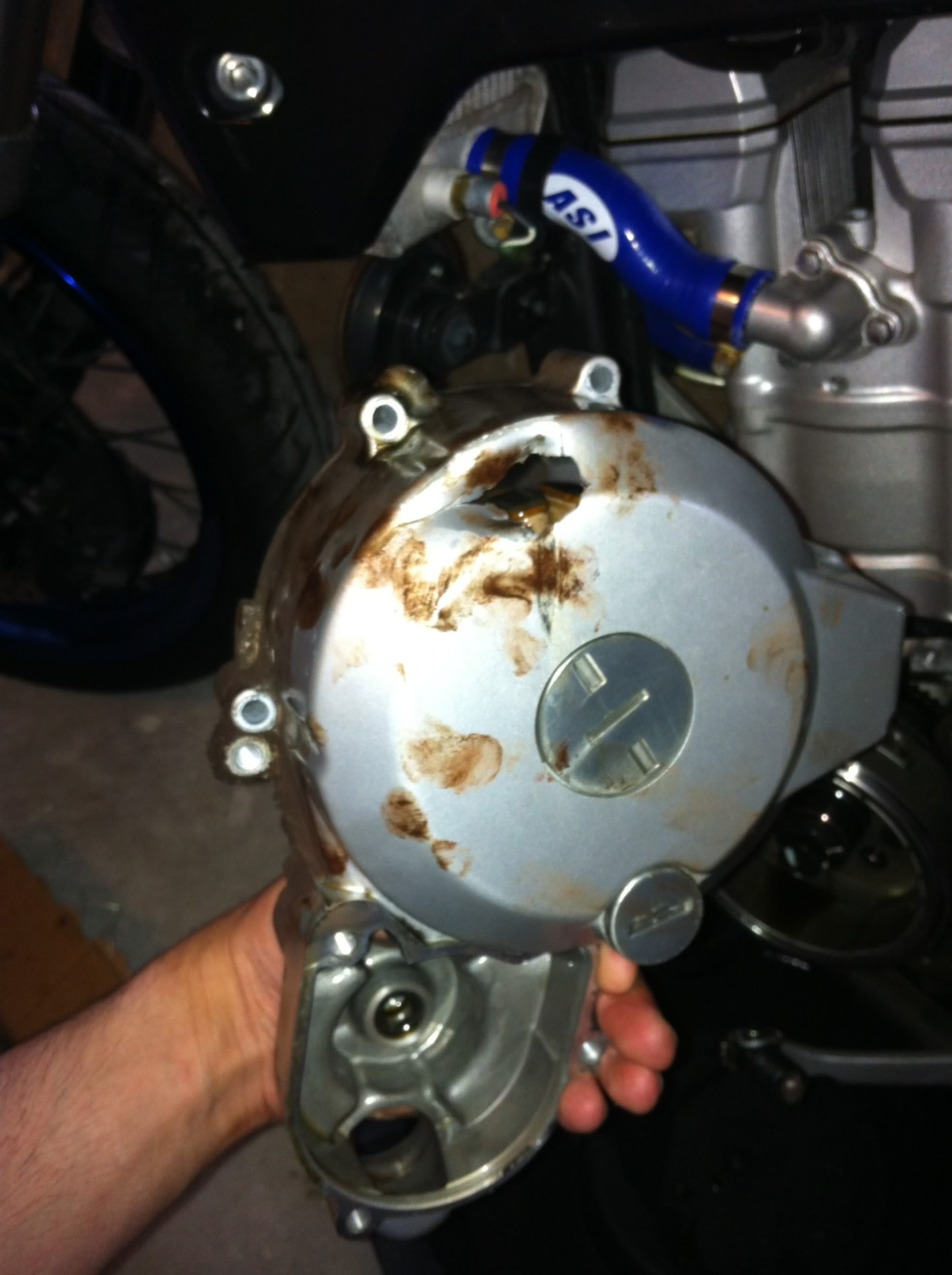

Why not just beat it out with a hammer and actually weld it?

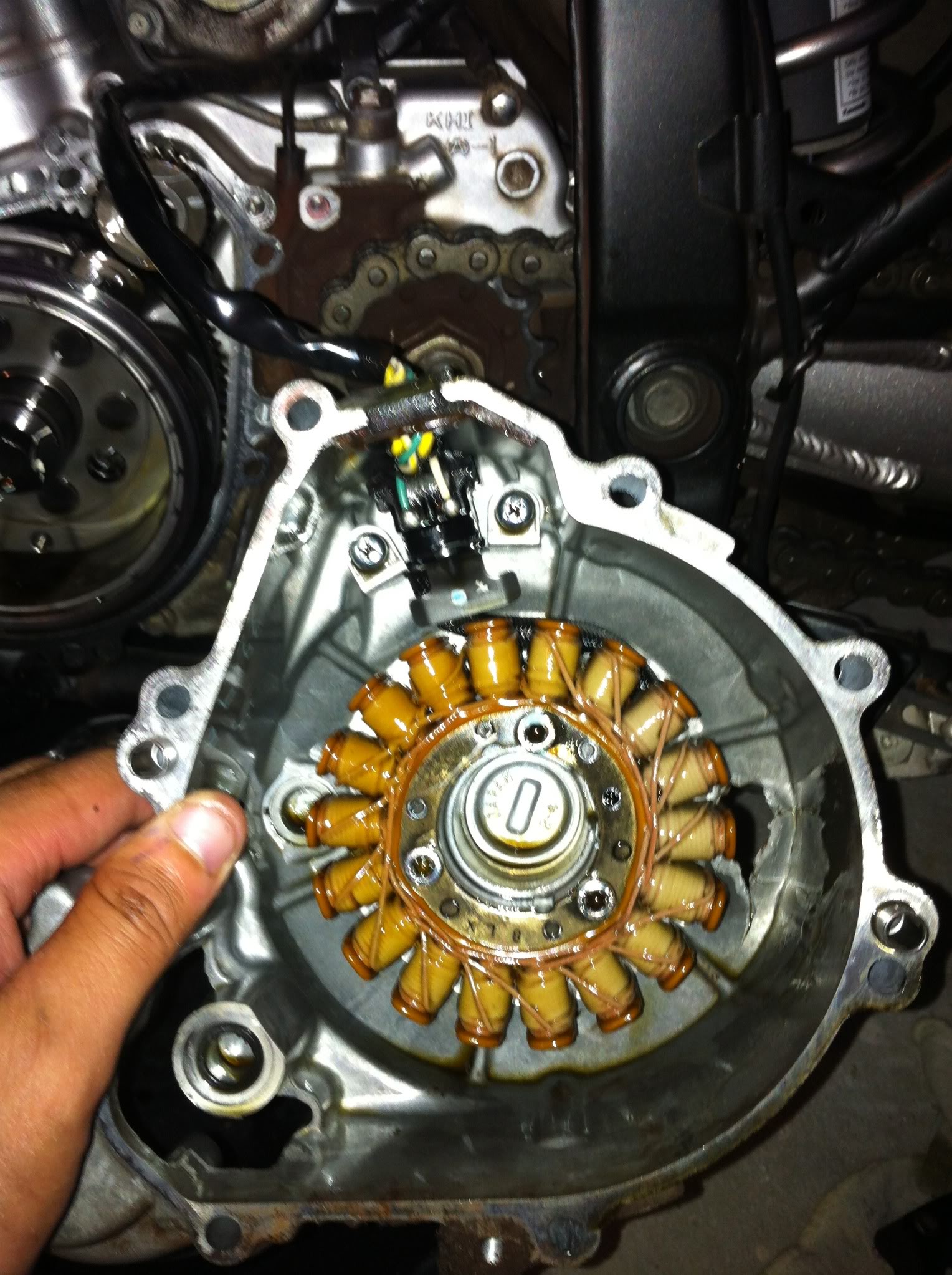

Hey guys I just took the generator cover off to see how it looks behind it and damn te gash is big. I'm not sure why I am looking at behind the generator cover in the pic below. I'm guessing I have to put the wire and that tan color circled in the new generator cover. Any suggestions as to what I'm up to now ?

Supa, you need to get a paper or downloaded manual and follow those instructions. No rocket science involved, but if you haven't done this job before, it's good insurance. You'll remove the stator there inside your cover, but I'd look closely to insure the puncture didn't damage the stator. You should be able to see if there's any damage when you remove it from the cover.

Take lots of pictures as you disassemble. Also be careful of the locating dowel pins, sometimes they are loose enough that they may fall out .
