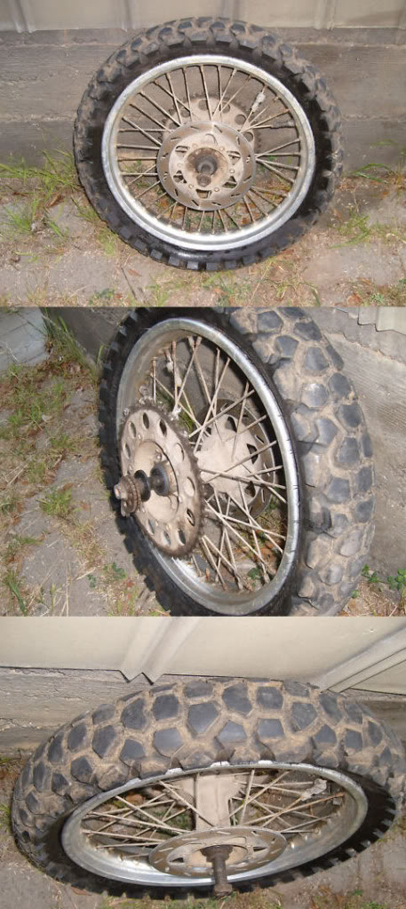

Rear: useable disc, sprocket & a tyre which is about 40-50%. It has a few small dents and at least 2 cracks in the side of the rim (pics at bottom, but not clear). From what I understand the rear wheel hub fits the 2010 model perfectly, but I'll let you know when I get them.

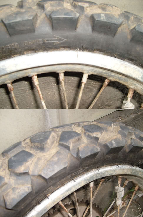

As you can see the spokes and rim are not in great shape. When I can inspect them properly I'll make a call on whether they are safe or not. If they aren't I will probably have to get a new rim and get it re-laced with new spokes. I guess that'll be expensive though, so hopefully I can avoid that.

I finally got around to test fitting the new rims today. After a fair amount of pain changing the rear tyre myself at home without any special tools, I can confirm that the rear axle off the the 1998 KLX300 fits the 2010 KLX250s perfectly. My only problem was that the sprocket that came with the wheel is a 50 tooth so my chain was too short for me to use the wheel just yet. I'm going to order a new 46 tooth from Rocky Mountain ATV to fit up to this wheel.

Yesterday I got my brother to help me change the rear sprocket and fitted up the wheel. After a test ride I can tell you that it's a perfect fit and works beautifully.
For those interested, on the 2010 model KLX250s, with a 13 tooth sprocket on the front, and a 46 teeth on the rear, you need a 108 link chain.
