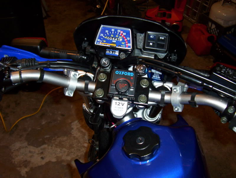

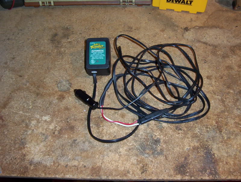

Here is my battery tender. And as you can see the hookup is awesome, it charges backwards through the 12V accessory plugs.

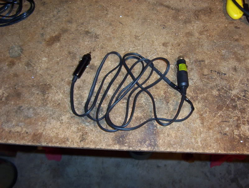

Jumper cables that I can use between the two bikes in case *cough* she leaves her key on *cough*

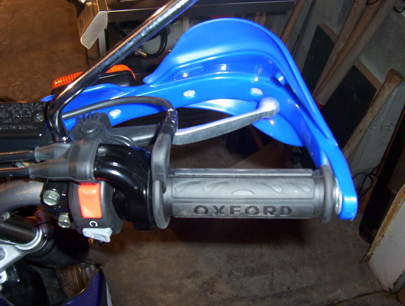

Her bike with the 12V socket and of course the heated grips, because lets face it, if its below 70, she ain't riding with out them. LOL

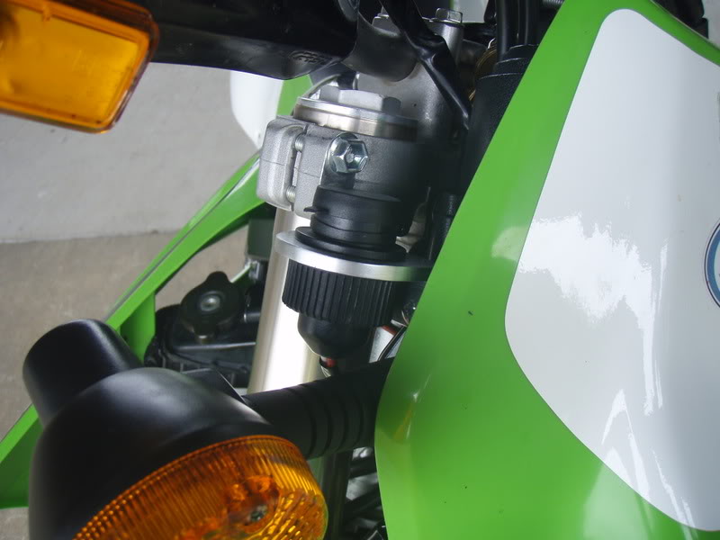

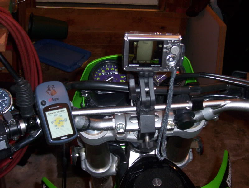

My 12 v adapter, and I just discovered that my GPS can be powered by the Blackberry charger, so now the screen will stay on as long as its plugged in.

Hmmmmm.... I like the 'battery tender plug into the accessory port Deej". Alot easier than taking off the side panel with an 8mm. The 12v accessory plug is a for sure mod this spring with that liitle gem of info. Very easy charging for those winter hibernation periods.
M
Old Mar 19, 2010 | 02:41 AM
Most battery tenders come with a pig-tail you bolt to the battery terminals, and leave hanging behind the side plate. Very easy to connect it to the tender then.
+1 for Deej's cig lighter outlet, it works just as well and gives you a power outlet for your stuff.
