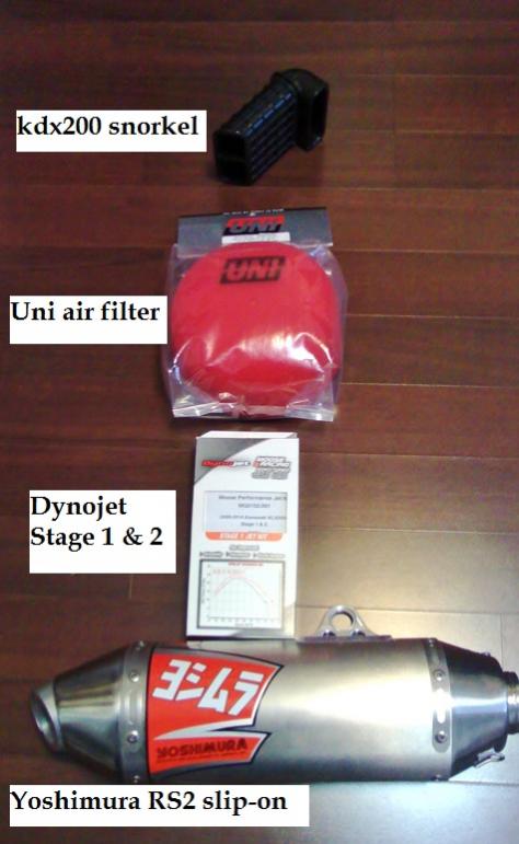

What would you tell the mechanic to do?
2010, US spec KLX250s
75% riding at 5000'. Other 25% 4000' -> sea level
55-75deg F year round
http://www.dynojet.com/pdf/2152.pdf
Attached Thumbnails Jetting recommendations for these mods-img_20140510_200118.jpg

Follow the stage two instructions but use one size smaller on the main due to your elevation.
