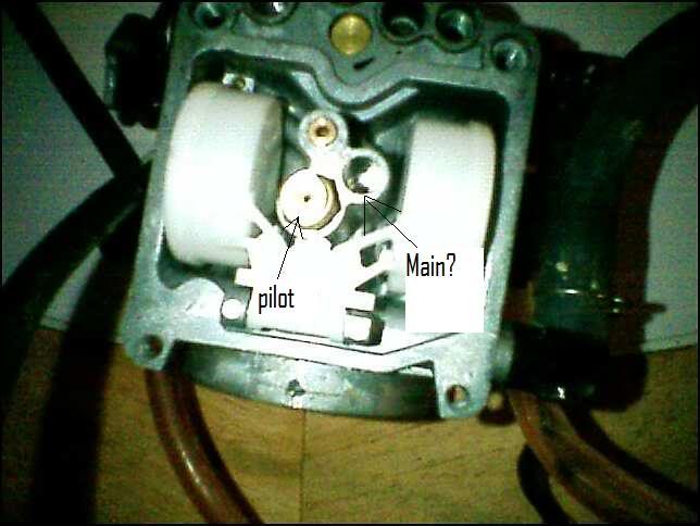

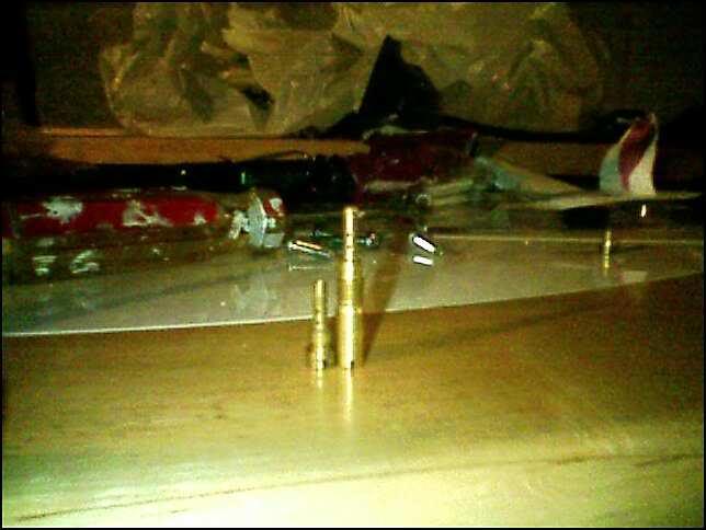

ok... i'm retarded or the kid at the shop is. I got the pilot screw in (the shot stubby one) to screw right in no problem.
but my main jet seems like its too long and its got some what of a "head" at the end of it. The stock one is a lot shorter and doesnt have any kinda head at the end. is the new one supposed to be like twice the length of the old stock one? The jets/pilot jet go in two of the three holes? where did i go wrong?

heres what i got.

the shorter one is my stock jet....

Ok, I have no idea what that big "jet" is that they sold ya.... the new/larger pilots look just like thestock ones they sold ya the wrong one.
take a pic of your main ..... you said it looked different than the stock one?
Old Dec 20, 2007 | 02:01 AM
Default RE: Jetting to be a lot like christmas!
Measure it and see how long it is, then match it up to one of these:
http://www.carbparts.com/keihin/need...n_jet_list.htm
That'll tell you what you got vs what you need. I'm guessing they ordered you a pilot jet for a CVK-V instead of the CVK.
