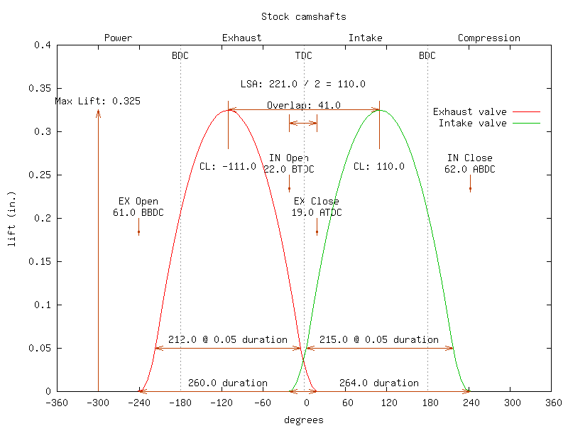

Off topic, but. The cam in this motor is more of an efficient street bike grind and doesn't really scavenge well, at 1mm lift (where measurable flow starts) it has almost no overlap. Why intake and exhaust mods will only get you so far, then you just have a loud pipe and an airbox that honks.

Rimbender, thanks for the valve graphs.
