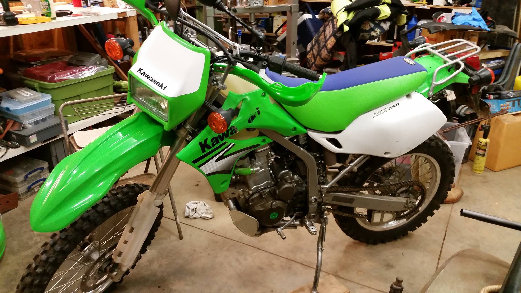

Installed a new KX-F front fender on my '07 KLX250s
Old Feb 6, 2017 | 12:44 AM
queen of spades's Avatar
Joined: Apr 2016
Posts: 389
Default Installed a new KX-F front fender on my '07 KLX250s
I like the lines.

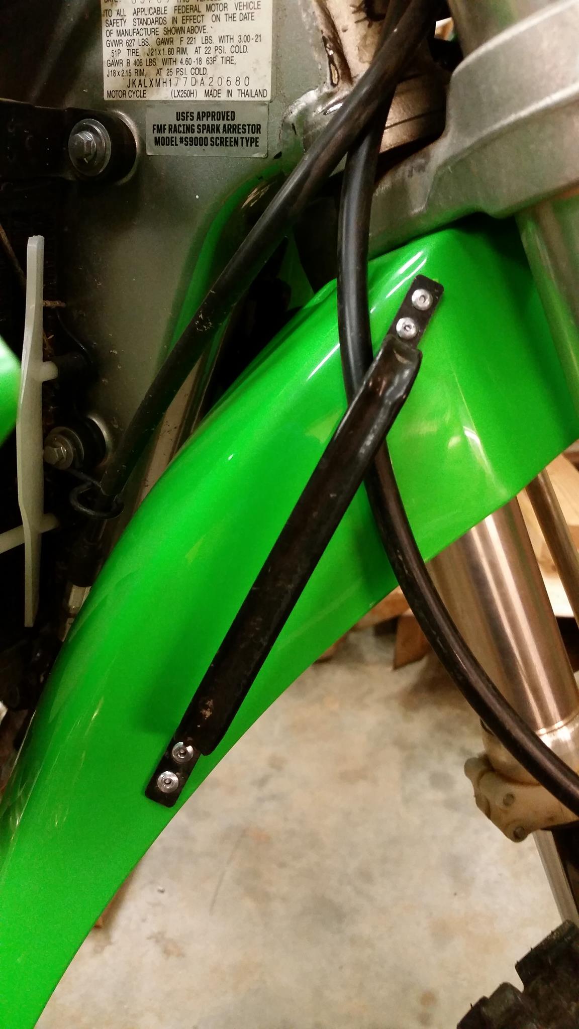

Replaced the cable guide on the new fender with some rivets just like OEM:

that looks awesome!! What year and model was that? And what modifications did you have to preform?
Old Feb 7, 2017 | 12:22 AM
Joined: Apr 2016
Posts: 389
thanks!
It's a 2007 KLX250s (first gen). No mods needed other than pop-riveting the cable guide onto the new fender.

For best results, swap the KLX fender bolts for the KX-F bolts. You'll need four of these:
92154-0972 BOLT,6X18.5 (PSP Kawasaki) $1.40
