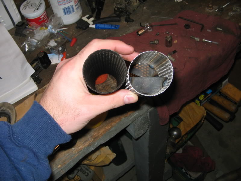

i ran the vortex insert for 5,000 miles... then ordered the quiet core... so it flowed better.
Race core on left (original) , quiet core on the left ( new part)

the vortex insert was more quiet than the quiet core..... but i didnt like how the exhaust flowed with it in... it runs better with quiet core.... it is just obnoxious with out either... did that for awhile... makes ur ears ring...lol

They are telling me that the quiet core isn't available for my EVO R because it is an 1 and 3/4. I that what yours is? Or do you have a 2 inch core? If it is 1 and 3/4 then where did you get it from.

my pipe is the evo x..... 2".... if you knew someone with a machine shop or able to weld stainless steel... all ya need to do is cut the core with a band saw, and put Stainless Steel sheet metal in and tack it in, in 3 places..... doesnt look that hard.... but it would have probably been more to have someone mod my race core than the cost of the quiet core...
