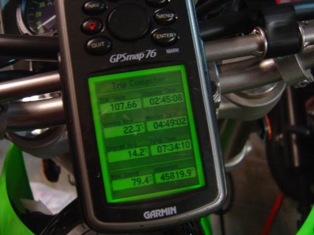

Ok, I took my bone stock KLX (600 miles on it) and just changed out the front sprocket to a 13t and it actually increased top speed. I used a GPS and the same stretch of road. It was a flat road with curves at the beginning the about a 1.25 mile straight at the end. With the stock gearing (14t) it could only managed 77.5 MPH when I changed to the 13t front it went 79.4. I made three runs with each and used themax speed on my GPS to get the results.
The 13t is faster because it lets the motor get into a better RPM range in 6th gear. With the 14t the bike just won't pull enough RPM's to reach a high speed. The 6th gear is more like an overdrive. I tried 5th and 6th for the 14t top and it went fastest in 5th gear. I know if you go down a long hill it would go faster but it won't keep it when it flattens out or goes up hill.
Next I will try the 45t rear to see what it will do on the same road.
Keep in mind that this is realGPS top speed, with every run the speedo was readingalmost 90 MPH!
Here is the 14t
Here is the 13t

What was your RPM going 79.4 mph with a 13 tooth sprocket?

I wish I kept up with that. It still would not reach max RPM's and it still slows down going up hill. I will take notes when I do it again for the 45t rear comparo.

EvildoerZX10R, what were your numbers for the others runs?

Not really sure because I didn't have the max speed displayed during the runs. I did check it at the end ofeach run but don't remember the exact numbers. I know the first run on the 14t was the fastest for that one because I never moved the max speed up on the GPS. The second run with the 13t was the fastest for that one. They were all within a couple of tenths or so.One thing I noticed later was the 13t holds the speed better goingup and downhills.
