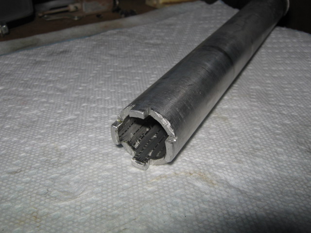

I just looked at the new and old springs side by side and the new ones are a good 1.5 inches longer than the stock ones. I have an 09 and there is a spacer at the bottom of the fork to shorten the stroke ie ashorter spring. Looks like I need to remove the spacers which means pulling the whole thing apart. Anyone taken their forks apart without a special tool to stop the pod from spinning?

red, I made that special tool that holds the damper out of an old aluminum bicycle seatpost I had around the house. Bike seatposts come in many different sizes. I made mine out of aluminum, as it isn't going to be a shop tool for years and multiples of use. I used a hacksaw and a file to make those 4 prongs. They don't have to be exact. This homemade tool worked just fine, and it was relatively easy to make. I drilled a hole in the other and stuck a phillips screwdriver through the hole to keep the post from turning.

I've always used a small 3/8 drive air impact wrench to spin those without a holder. have also got them loose by just wackiing the end of a socket drive or allen wrench sharply. Might give it a try?
