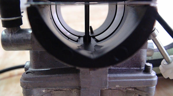

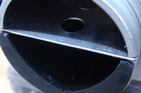

I decided now is as good a time as any to dial in the Thunder Products VIP thingy and see how it compares to when this 40mm carb had dual vertical inserts..

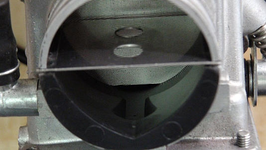

These tabs on the engine side were supposed to kind of gouge themselves into the intake's rubber and lock it in place, but that makes it almost impossible to get the thing in there straight unless you install the carb and intake as a unit-which is very hard to do with this 40mm as there's an unused port nipple on the carb poking up right in the way of trying to tighten the RH intake bolt.
Up to half throttle the divider concentrates the fuel/air mix into the lower half of the carb throat increasing velocity. I guess low end power is improved; I wasn't really testing that part of it while checking the a/f ratio. More tests to follow.
So far I've had to lean both the needle and the main jet, even though the instructions say typically you have to richen the idle mix and needle.. But the 40 previously had the dual vertical insert guides and that's the jetting I am coming from.
Limited testing shows the a/f ratio jumping around at WOT. That long divider plate might be upsetting the a/f flow at WOT even though it has 2 holes in it. (looks like I need to de-burr those holes a little doesn't it)
I'll use the a/f meter to get the jetting as close as i can, do some timed sprints, then put the 36mm back on and see how to the two set ups compare. The effective carb size has been reduced some from 40mm due to the plastic V-shaped insert's design-but we'll see what happens with it.
