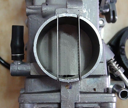

When I set off on this adventure with the 40mm, I'd already assumed there were ways of perking its flow up should it prove to be a little too large of a carb. I already have it set up for a single divider in the throat (which I photoshop'd out), so after testing the 40 with its 155mj, I'll switch to the single center divider and see how it runs.
Since that photo was taken I've bent over the ends of the insert tabs that run through the carb spigot's top and bottom, to have the inserts be sort of self locking and self centering, and also to have them stay perpendicular to the slide and parallel to the direction of flow.
