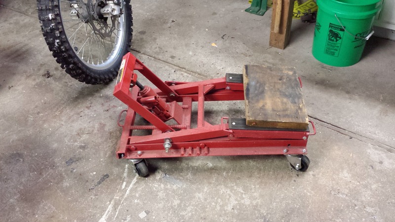

Old Jan 24, 2016 | 07:14 PM
I should make something a little more solid, but ........

Old Jan 24, 2016 | 07:47 PM
klx678's Avatar
Joined: Aug 2009
Posts: 4,656
From: Delaware, Ohio
Y'know you could drill and put on a couple angle iron arms on the base of the lift to work as anti-tip, maybe a couple clamps that would swing over the bottom frame tube on your scrap wood piece if big enough
