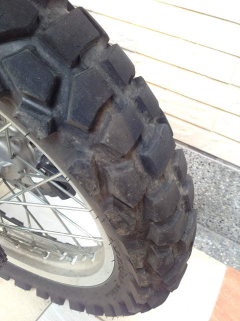

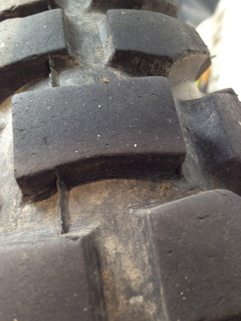

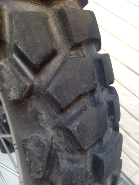

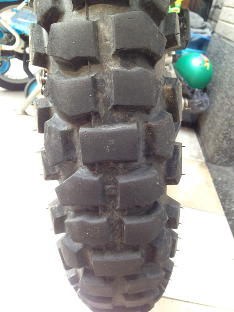

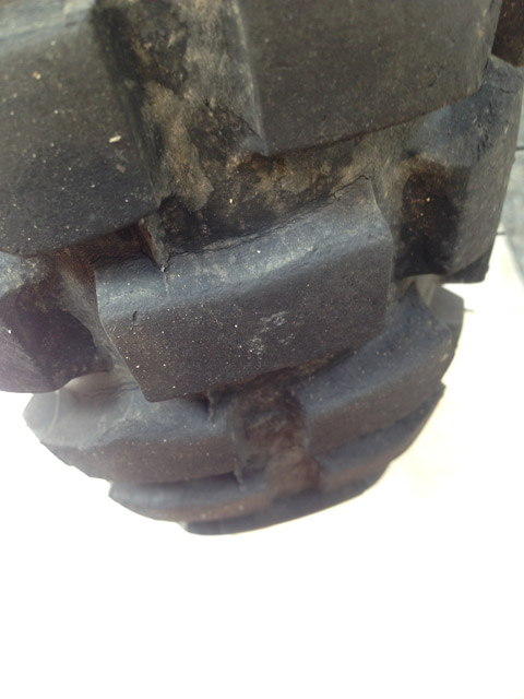

I'm not experienced in off-road tires and at what point you should change them. I've been running the the stock 605's for about 4500km (2800 miles). I think they still look fine, but wondering at what point to change them.
I'm surprised at how well the rear handles the terrain I ride. Front, not so much. I'd change them now, but hate to throw out a useable set of tires.
Here's some pics...

Not bad. The ***** still have square edges and good hight. Looks like they are starting to dry out and you may start to rip ***** off. With the power of the klx I feel you got time still.
When you are ready look into Kenda track masters. I put a pair on my plated kdx 220. Good street manners (as long as you are not trying to drag pegs)and awesome off-road. You would never think they were DOT.
You can get a pair for around $100 shipped.

I think you can go at least another 4500 Km. My D605s got 13.000 Km on them and the rear still got around 2-3 mm left but the front looks bad. Just ordered a new set

I go by feel. I'm running a 60/40 road/off road and when the center flattens to a point where it gets wonky cornering hard on pavement is usually also about the time when I feel it not getting decent traction on loose surfaces. That's when I put on new tires. I'm going to say ball park 5mm tread. Just spins and when I lean over I can feel the transition from the flattened center area to the sidewall, quite noticeable because I'm usually chasing a friend or two on their supermoto type bikes.
Yours looks good for some more time, but think about the feel while riding, you'll see what I mean. Order far enough ahead that you don't have a lot of down time or back order on the tire(s). I usually do both tires since my front is heavily cupped and won't go two rear tires.
