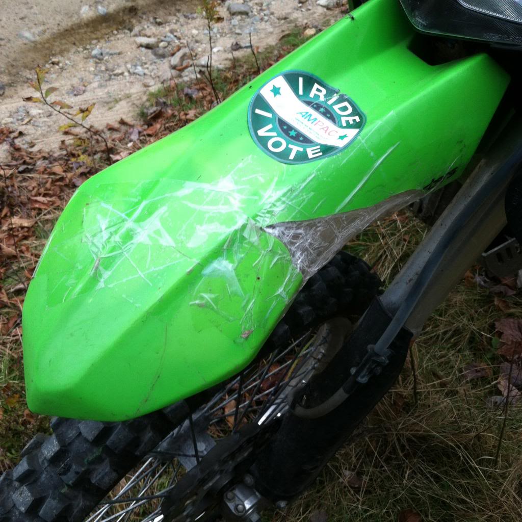

Originally Posted by fenderworks2
Hopefully the pictures show this....
pretty rough feeling....not just the stickers, but into the plastic a bit.
any suggestions on how to fix this?
Fix what? Your bike has battle scars, it has character! You wouldn't shred your kid's first A paper would you?
why avoid the opportunity to tell/make up a juicy story on how it got said wound
Add a little packing tape and most of the missing pieces and you get...

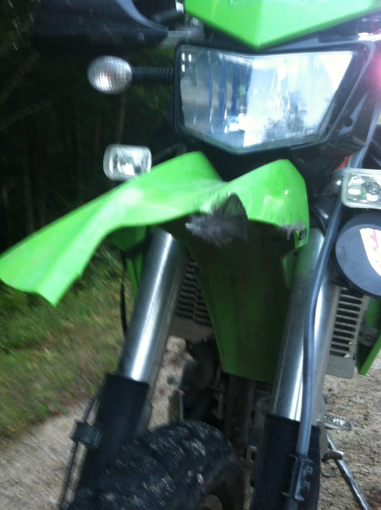

Battle scars, chicks dig'em.

Straight razor blade scrape off the little shreds of plastic then hit it ever so lightly with a mapp gas torch. It'll bring down the high spots, then sand lightly and slap a sticker on it. Less fugly for sure

ive heard fine grit sandpaper and a heat gun sparingly to smooth out. will loose its shine but be smooth enough for graphics stickers to adhere

Thanks you all for the suggestions. will be working on this next week. I got to get some stickers!
