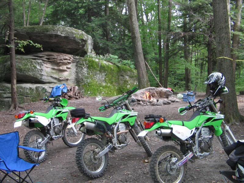

I am very happy with how the paint is holding up..... even been down a bunch of times..... all i did was go over it with a scotch brite pad, to roughen it, then cleaned it with alcohol, and used Krylon Fusion Plastic paint, no primer.... u can see how it looks....

wow eric that turned out nice for comming out of a can props
