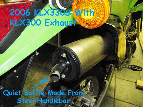

I have a KLX300 muffler and header. The only difference between the 250 and 300 headers is the exit diameter. The KLX 300 header has a bigger exit to fit the 300 muffler. Mine muffler came without the baffle, because some spud removed and lost it. Exited to receive my new setup for my 330, I fit it and was sorely disappointed to lose power on the low end. The bike ran like crap and did not respond well to jetting changes. I use the low end and midrange a ton, so if the bike only runs great WFO I consider the mod a failure. I took it off the 300 pipe for months, put it up for sale, and got a CRaiglist scam email. Pissed off, I thought I'd give the pipe one more try, this time making a very quiet baffle from a section of steel handlebar. The bike then ran better than the stock setup, and it wasn't irritating to me or others.
If you do run the 300 muffler, I strongly suggest not pulling the baffle out. If you don't have one, make one.
