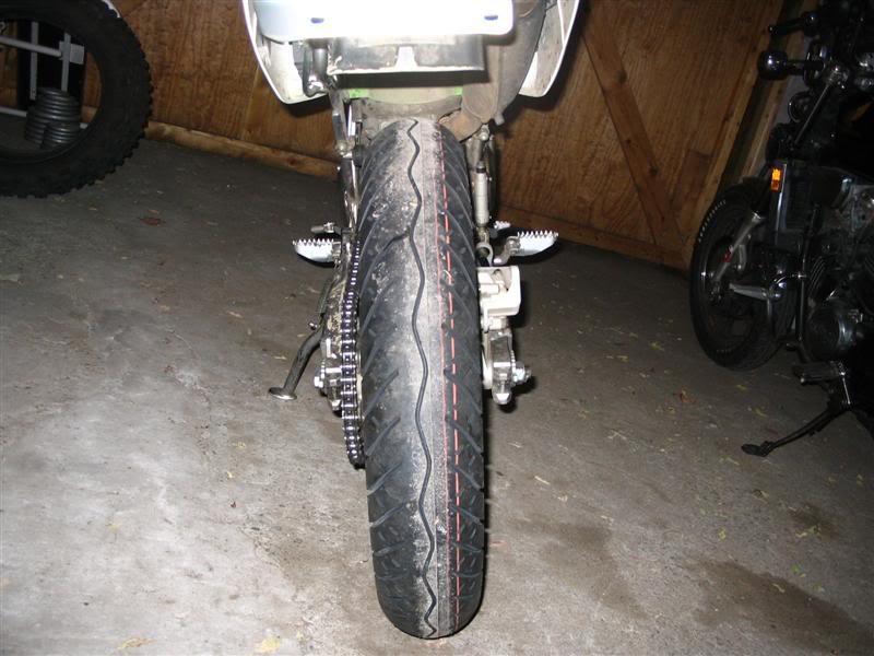

Yes, stock cable works fine, you just remove the "push" cable. The throttle control is the same as the oem, there is no ramped cam, it just has a larger overall cam, no surprises anywhere. If you crank on it the same as you do with the original you will be clawing the sky though. Unless I get a really good position on the throttle, the most I could manage with a quick wrist snap was half throttle, now that same motion brings it right to the stops at full throttle.
Keep in mind that the above tire is not going to get much grip on semi frozen grass anyway. On the hardpack and pavement it sticks like glue.
