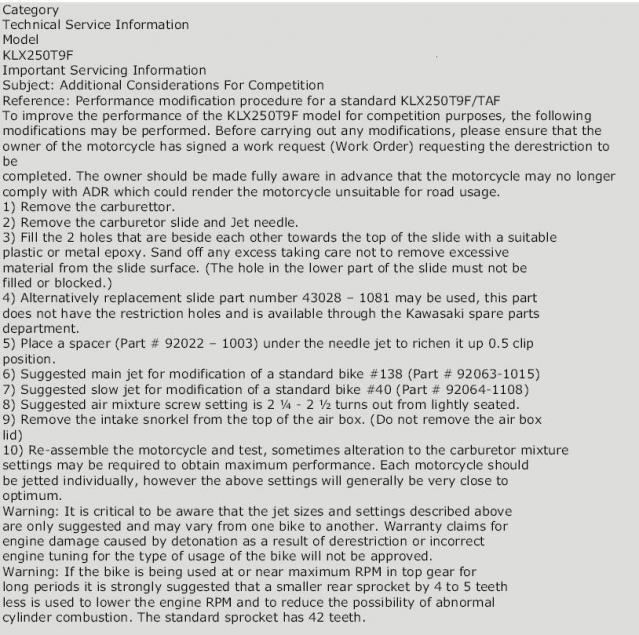

I found this Kawasaki Australia service bulletin that explains to dealers the procedure for removing the ADR (Aust Design Rule) slide to derestrict the engine. Aust bikes run higher ignition advance (10 deg more >5000 r/min) so I guess they can run a bit richer to prevent pinging/detonation.
Ok, all i know is the #40 kawi pilot jet was way too rich for my bike as a 250. You could try the #38. If you really are gettin poor economy.
