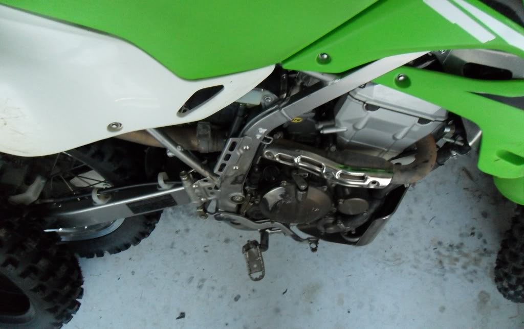

From: Gold Coast Australia
I used the stock heat shield, stainless hose clamps and a couple of brackets and mounted that to the header.
It works great, has lasted for ages with no signs of falling of, didn’t cost a cent and doesn't melt my pants.

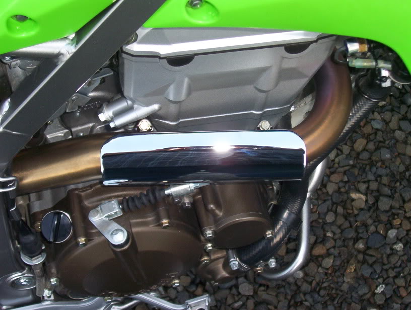

But if you want to add something different then you can always go the route I took. I was in the shop shortly after the Muzzy install and spotted a chrome job on the wall by the road bike section, and it just caught my eye. And yes its been on for over 12,000 miles and still looks that good! Not sure if it will fit over the power bomb but I bet it would,

neilapples's Avatar
Joined: Jan 2010
Posts: 177
wow, Deej do you actually use your bike? its soooo clean.
