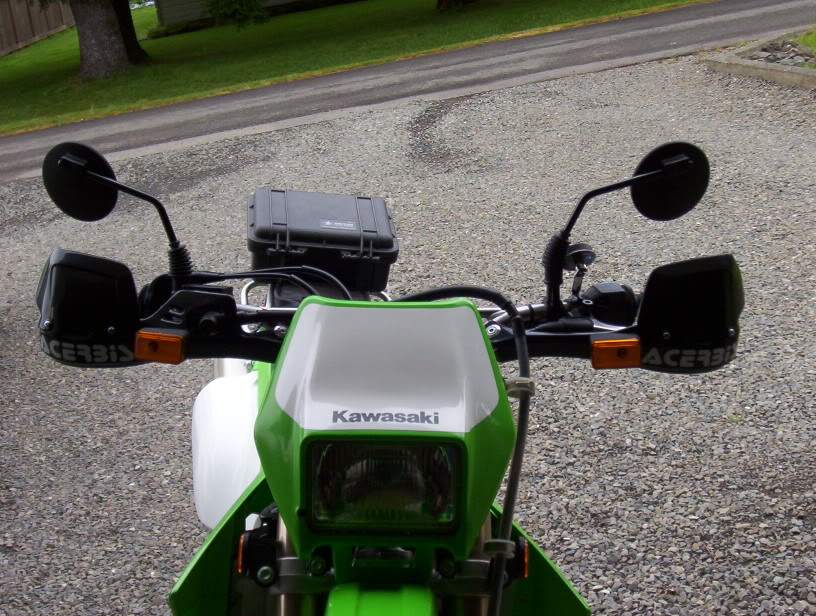

I'll see if I have a picture somewhere, but as far as the clutch cable goes, I tried running it over the top, and then under and either way it put a hard kink in the cable, so I actually drilled a 3/8 hole in the hand guard and it let the cable go right into the clutch perch in a straight line.
Nope you can't really see it in this picture.
Old Apr 15, 2008 | 10:28 PM
Default RE: HandGuards
Well if you look close you can
