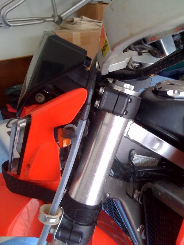

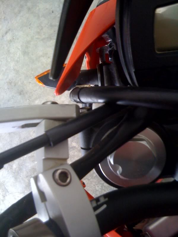

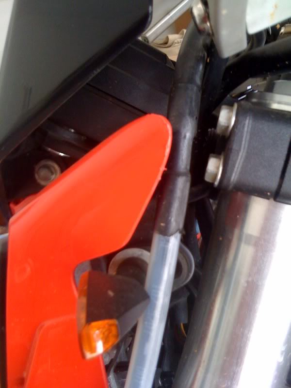

Since pics of my bike are being used as an example, I thought I would post up some recent pics. After bangin around in the woods, I had to change some things....
You can see that the top guide ring is now completely gone.
This spring I'm going to get a stainless steel line from Bill Blue, so it'll change again!
