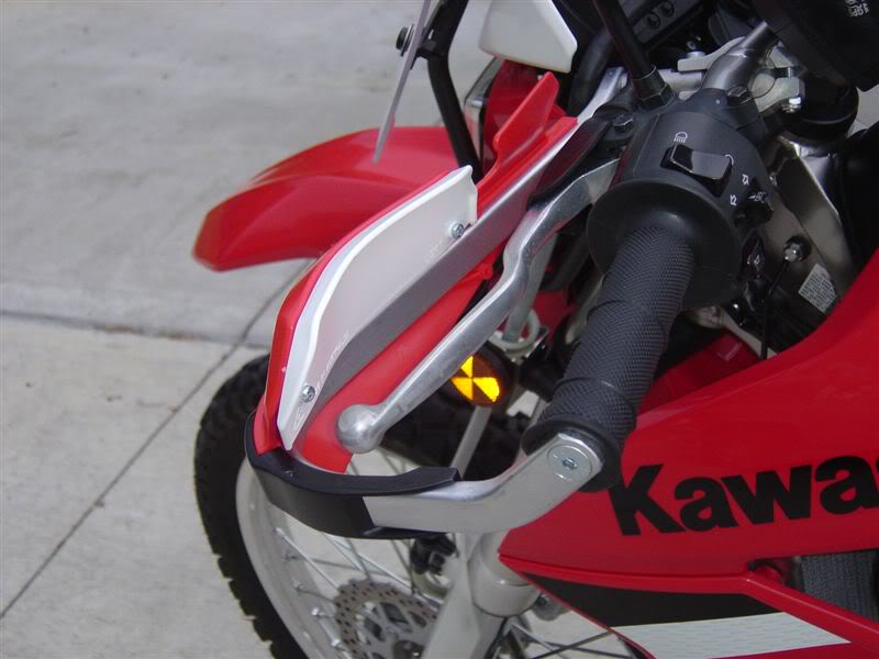

Barkbuster VPS or Storm will clear stock levers on stock bars.

Bob, my comment about trimming levers wasn't because the stock levers wouldn't fit inside of the various barkbuster-style handguards I've used over the years. It was because I don't like that space being taken up by what is to me the relatively useless piece of aluminum on the end of a stock lever. Guards are great, but when you need to grab and tug on the bar and/or guard to pull the bike out of a hole, back on the trail, or for a myriad of other reasons, having that space taken up with useless material is an issue to me. I don't even know why levers on more modern bikes are still these huge, old school designs and shapes. With disc brakes, better cables, and more efficient clutch pull designs, you don't need a huge lever to operate these controls...unless you're limp-wristed...and then that's a whole other problem.

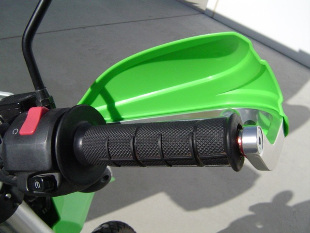

I found it wasn't too bad. I had to drill & tap the bar ends to M8x1.25 thread; pretty easy as I have access to taps + the end is already centre drilled so it is a good guide. I then purchased some countersunk head M8x40mm bolts.
Then it was a matter of neatly cutting away the end of the hand grips - easier for the throttle one as you can remove it from the bike. The last thing was spacing the aluminium piece away from the end of the bar. Luckily I had some small OD anodised spacers left over from a toddler car seat anchor kit. Perfect. Throttle twists & returns freely and a neat job. I couldn't be happier.
