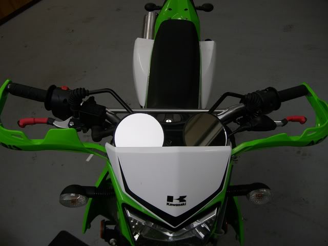

I got tired of pinching my fingers on my clutch hand so I wacked the little bugger off.

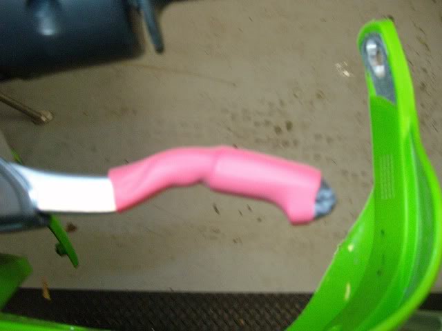

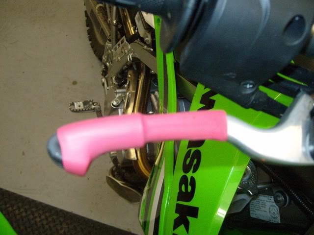

Someone on here had said that they had used heatshrink to cover the stubend, so I decided that I would make my own custom levers.

If you can find the tubing that has a sealant inside for the first layer, it is thicker than regular tubing. Make it about 3/4 inch longer than the lever and after it has been shrunk on, fold it over and slide the second larger piece of regular stuff over and shrink it to hold the first piece folded. The levers feel pretty good!
