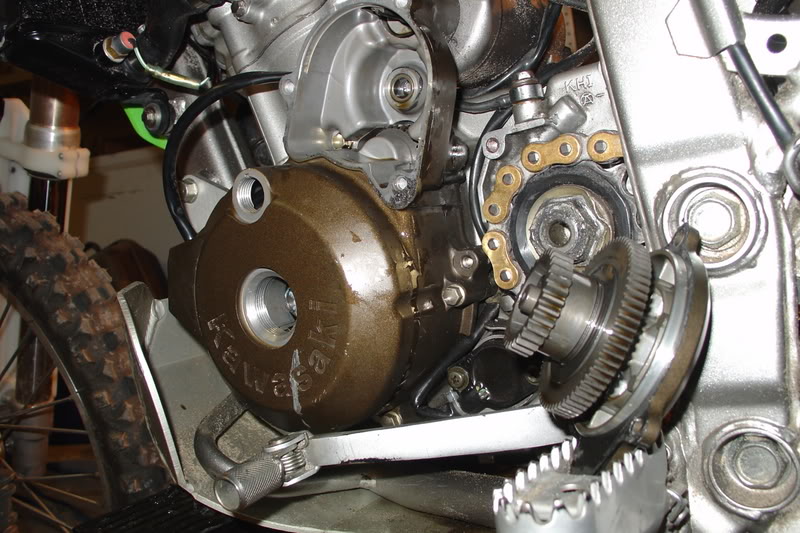

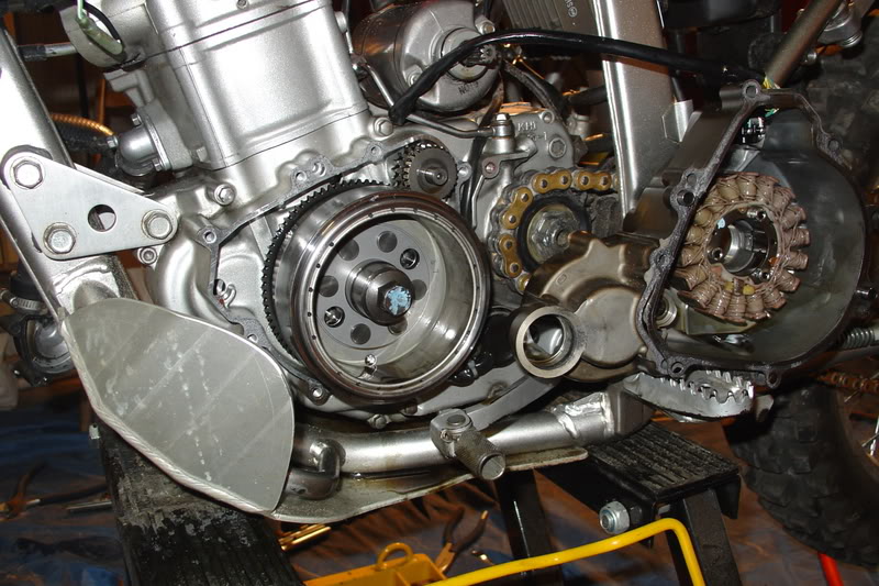

thanks for all the quick replies. Does anyone of you know what awaits me behind the leftside cover? Is there any oil in there or lose parts that are going to fall out as soon as i open it?
You'll need to drop the oil first. You'll need a new gasket to fit it back up when you're done.
Image credit to Finger.
