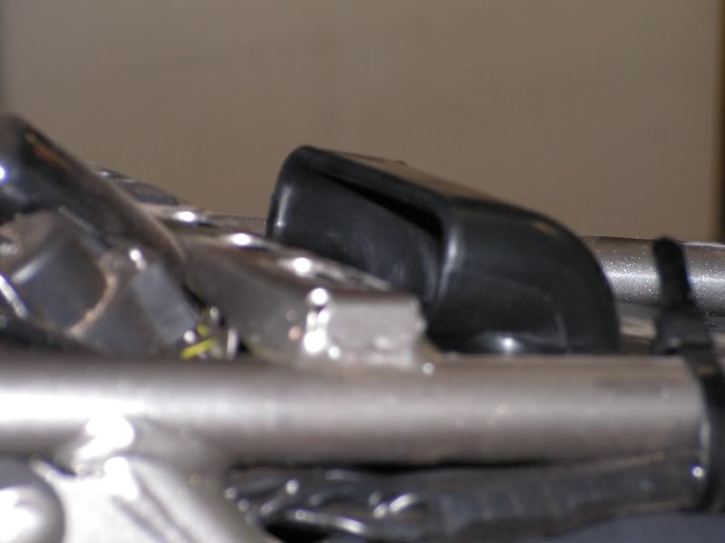

Hey Marty, do you have a picture of the kdx200 snorkle? I have been thinking about getting it and I just wanted to see what all the hub bub is about....

Here's the stock snorkle lurking under the seat

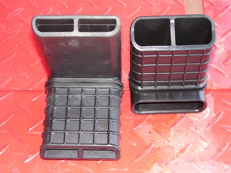

Here's a comparison shot between the two. Which do you think flows more air?

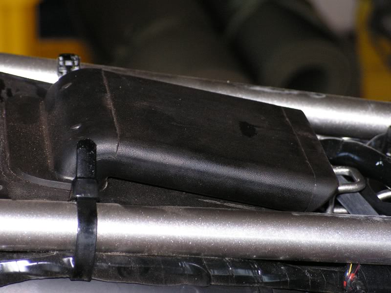

Here's the new KDX snorkle installed with the opening facing aft - kinda looks like a scoop on John Force's funny car!

All my parts just arrived for this so I'm about to undertake this same procedure. Just curious - why face the snorkel aft? I can't image that would affect air flow. Is it to reduce the likelyhood of water entering the air box or something?

Under the seat there is not much aero advanage, so I chose facing the rear as a precautionary advantage.

Brian, turning the snorkel around was necessary to stop carb icing in the cold fog and rain for my bike.
