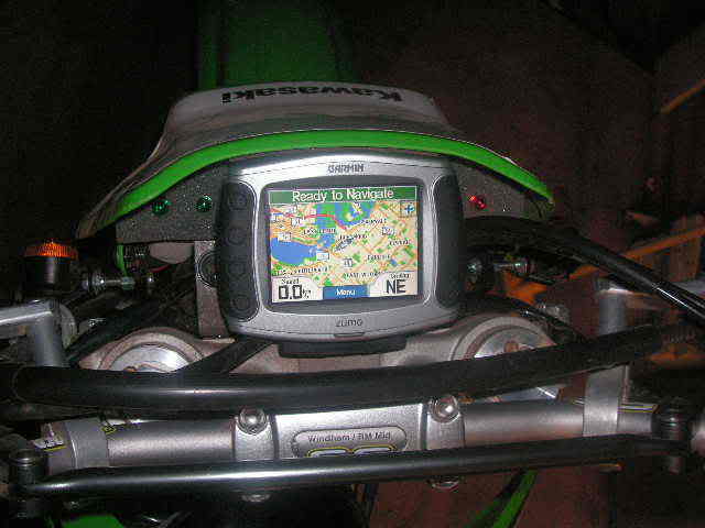

ORIGINAL: neilaction
A bit of work but the result works well for me.
Very sweet neil, and I know my gps's. If you want the best get a zumo like neil...awsome garmin product made for bikes with left hand controls w/tft display and totally waterproof. I want one but it's about $500 right neil? and I got a perfectly good garmin chartplotter I use on my boat that I rigged up to switch out an work on my 640 advand my klx in a pinch. Just gotta put in a land baseddata card. Nice job man I'm jealous.
Deej you want to hard wire any gps if possible....they suck no juice as far as the klx is concerned but even the small ones will eat some batteries.
Oh Neil, get a photobucket account and embed dem pics

Hey Neil, after posting your pic .... I just noticed you made your own dash with your warning and indicator lights, thats tight! I know the gps will give speed .... does the zumo have a tach interface or do ya just not worry about it?

Yep I did pull out the original gauges and made up the one you see.
The Zume 550 comes with 2 cradles.
One is a fixed cradle and that one I mounted on a bracket and fixed it to the triple clamp.
The other has a suction cup which I take with me in the car.
I just unclip the Zumo when I need to.
You also get bar mounts but a GPS looks very vunerable up there.
Ishaped some high density foam to mount the warning lights to.
I don't worry about a tacho. It's just not needed IMHO.
The whole GPS sits just below the top edge of the headlight shroud.
It justs looks like it's part of the bike and is out of harms way when I stack it.
Another kinda useful feature is it has a "fuel gauge".
Well you program in the fuel tanks range and you need to reset when you fill up.
It then warns you when it thinks you are getting low.
The only down side is that I lose the ignition switch and lock.
I had to cut part of the top triple clamp to remove the alloy ring that sits around the key switch.
I have just mounted a toggle switchbut I guess I could have sourced a key switch if I wanted a bit more security.
Oh and you lose the odometer.
I have no idea how many k's I have done.
The Zumo only has a trip meter and I use that as a trip meter.
I thought about never resetting it but then I couldn't use the GPS in any other vehicle.
The Zumo 550 cost me $1500 Aus dollars.
That's about $1300 US.
mmmm I should have waited and bought it online.
Oh well. I am not a patient man.
Cheers
