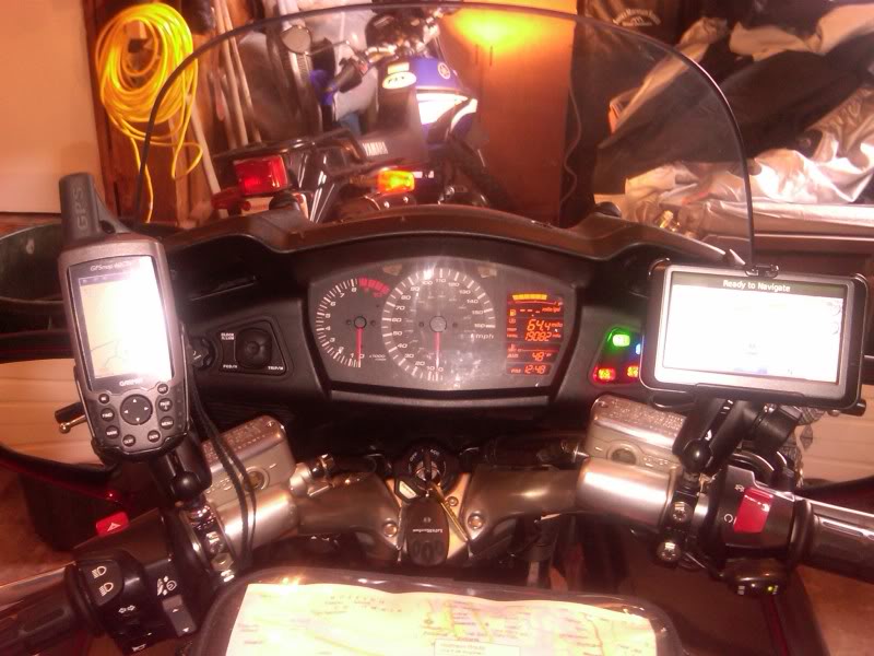

I got 2 ram mounts on the Honda and one on the KLX. They all work perfect!
Old May 23, 2011 | 05:34 PM
Matasickle's Avatar
Joined: Apr 2011
Posts: 579
From: CT
Those mounts do look sweet.. How do you waterproof those suckers?
