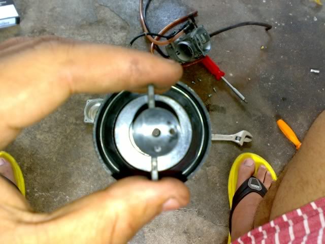

I just finished jetting my bike and testing it about 2 Hours ago.. The process was very easy and I'm proud I did it all ALONE! Pretty good for a 16 yr old huh?
The jetting specs are :
128 Main Jet (stock was 118)
35 Pilot Jet (stock)
DJ needle with clip on 3rd Position.
Mixture screw is 1 3/4 Open..
All I can say is WOW!! The bike wheelied a little on first gear without clutch! Starts half turn.. I took off the air box lid too.. And I drilled the slide vent hole with the drill bit given in the jetting kit.. The mixture screw wasnt covered.. I had to drain all the coolent too Because of the Carb De Ice circuit!
Anyway heres some pics I managed to take..

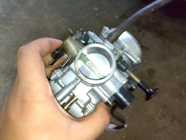

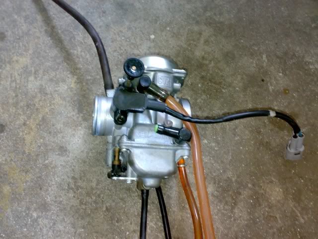

The virgin carb hehehehe..

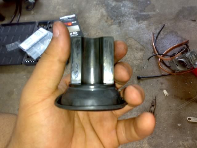

US Style Slide (no extra holes)

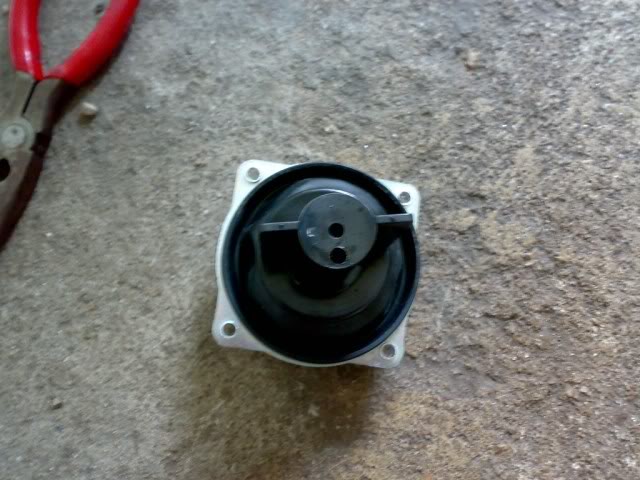

Slide holes before drilling
After Drilling

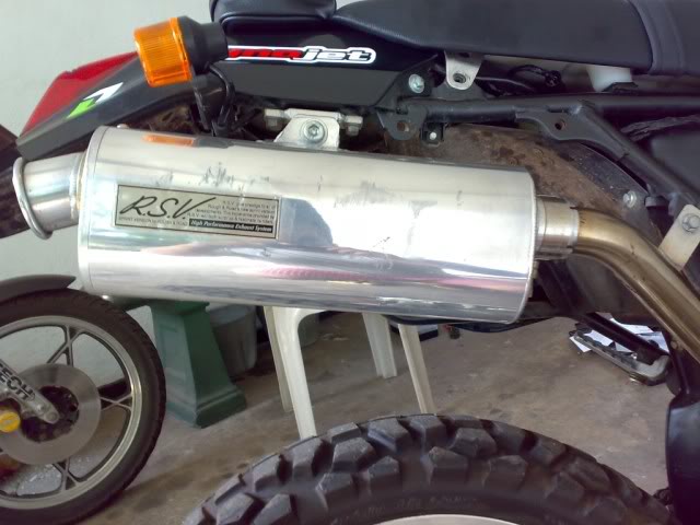

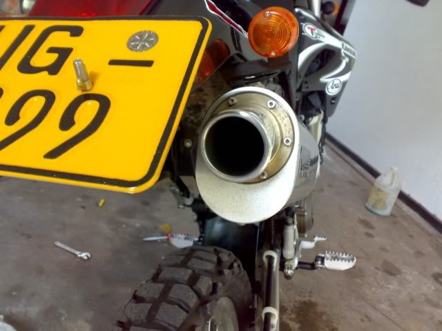

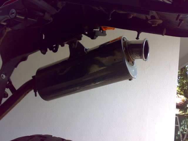

The RSV Pipe

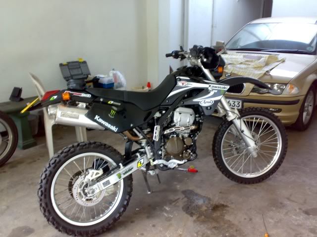

The bike
