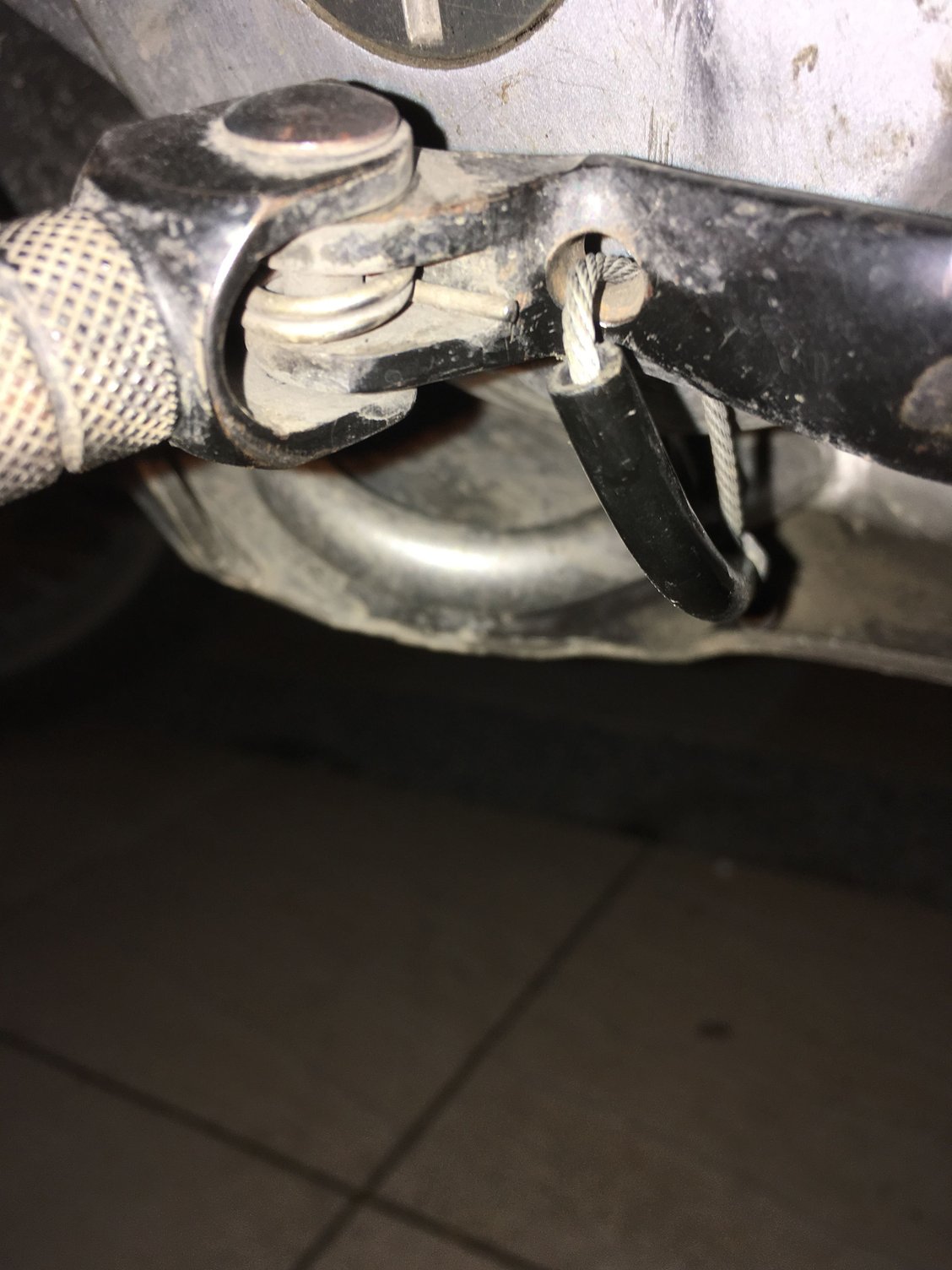

I’ll throw my experience using an MSR XR650 lever. I’ve gone through two of them now, as they’ve both bent in a crash. I’ve seen the comments about them not bending and that got me wondering. Both times they have bent right where I drilled a hole to put my brake snake. (Right at the bend at the end, towards the end of your foot) Apparently weakening the metal in that spot is enough to make it bend? Just pondering here, but you could drill other spots in the lever as well. But seems just that one spot is enough.

Do you have a pic handy so we can see along with your text?

This lever is currently bent but still useable. Not saying drilling will prevent other damage but a possible solution.

Since I've already wasted $ on the AL shifter it won't hurt to modify it a little. I may add a couple smaller holes where it snakes out around the case. Would rather brake the shift lever in a crash than the shaft.

Not a bad idea on the drill hole. I have the MSR on my bike, I still use it. I haven't broken the shift shaft but it did snap the weld on the shaft securing the pawl to the shaft. Don't know if the shifter was completely responsible(I had a pretty big role) but it wouldn't hurt to add the hole.
