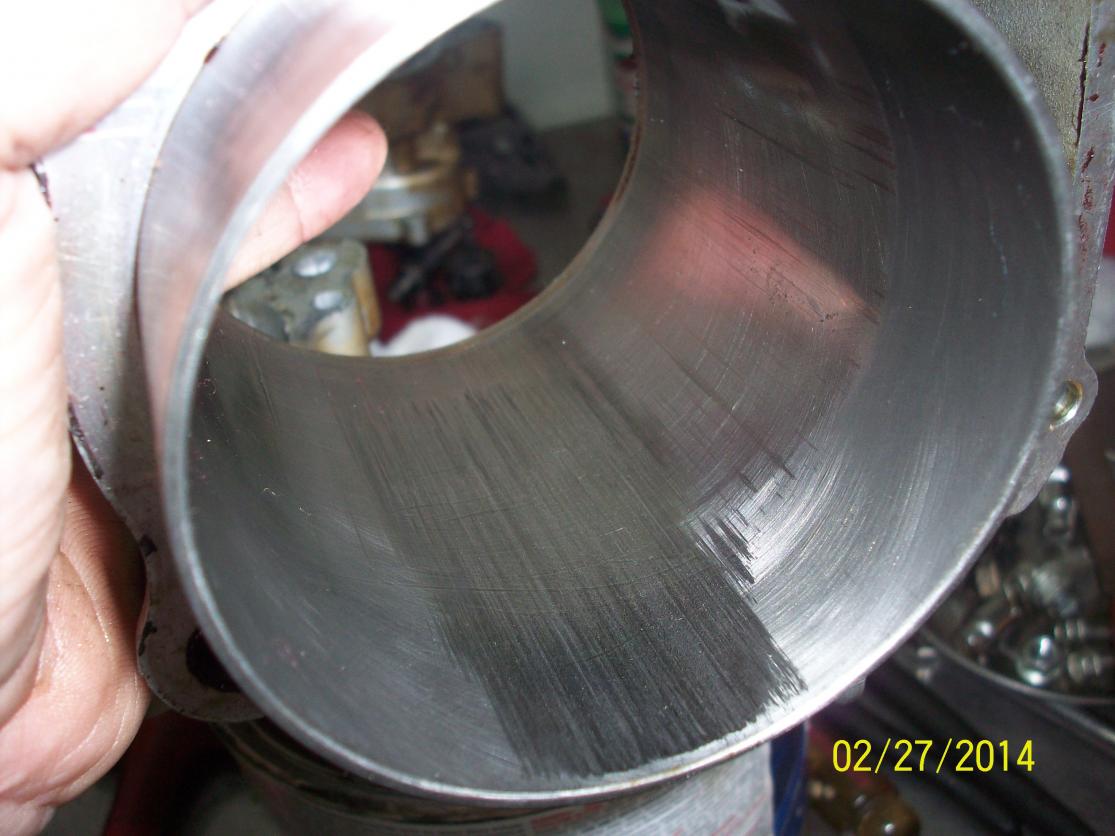

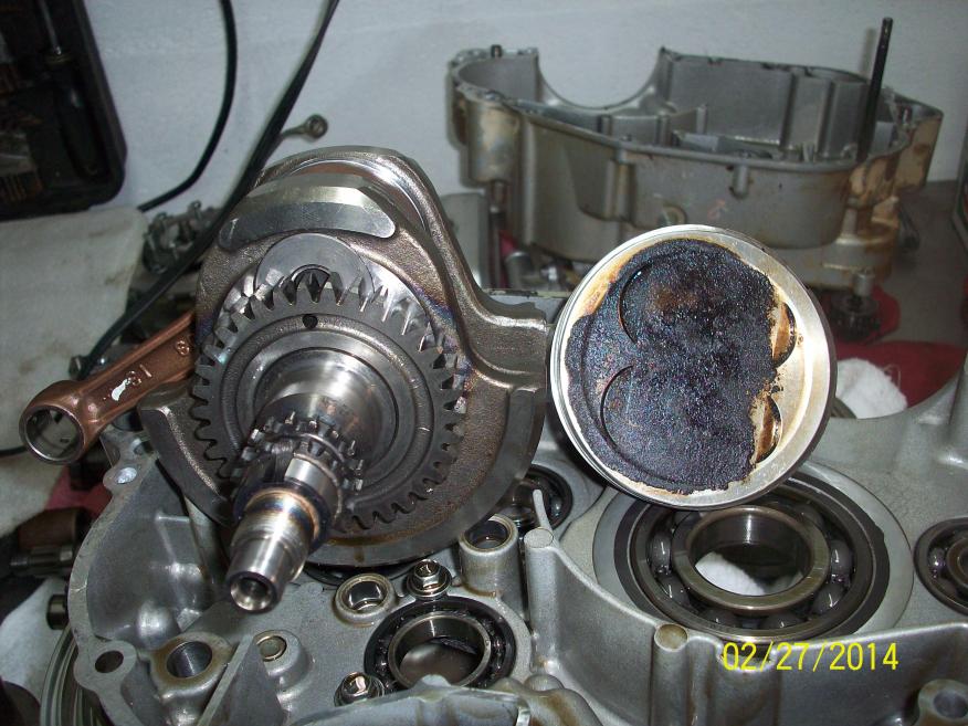

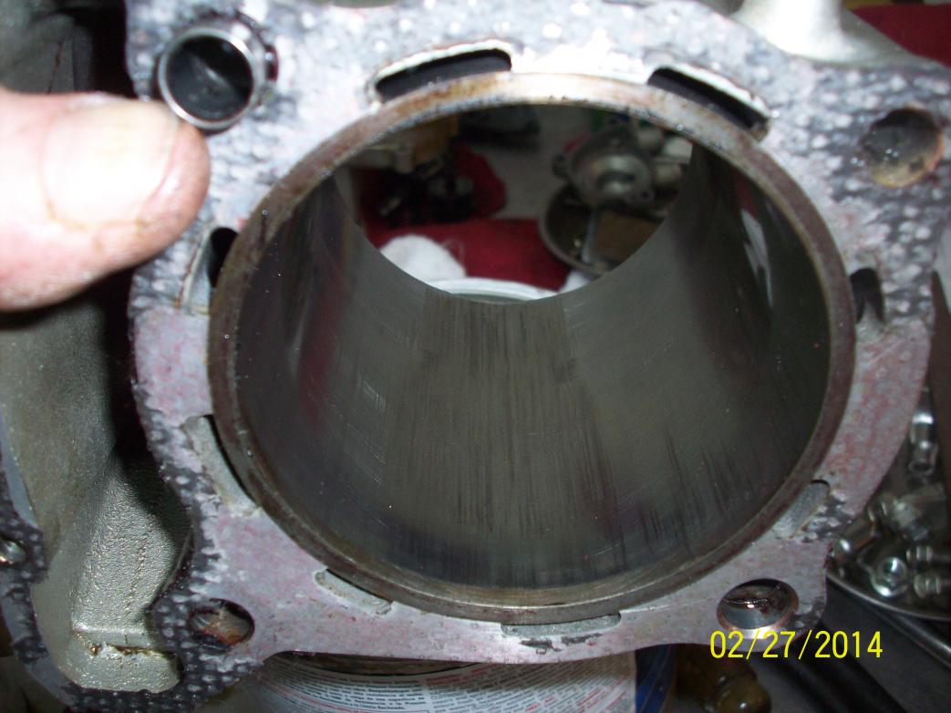

Especially on an engine like the KLX, oil starvation, interruption, or otherwise almost always manifests itself by evidence in the head at the cam bearings...or the cam interface with the head since it technically has no bearings installed there. Before the crank would go because of oil, you should see some galling, scuffing, or other evidence. If the head is OK, the crank problem probably cam from another issue.
First thing I checked for was any evidence of damage to the valve train-every thing is smooth as glass so it definitely didn't have an oiling problem. The cam is the only part of the engine that uses a plain bearing support-if it doesn't have enough oil pressure there will be metal to metal contact immediately. I looked at all of the seals on the side cover where the oil circuit transfers to the crankshaft and everything looks perfect. I spoke to Bill this afternoon and he asked me to ship the cylinder and piston to him for inspection. He has a .010 over piston in stock for the 351 so he thinks that he should be able to salvage it.
I also spoke to Vince @ Mr. Crankshaft in KY about the possibility of rebuilding the crank. There is not a rod kit listed for the KLX so he is going to disassemble the crank and see if anything will match up. It's a long shot but at this point I'm willing to be the guinea pig for the good of the model. If he can't find a replacement I'm only out the shipping cost and if he can I'll save over 1/2 the cost of a new replacement. Fingers are crossed
