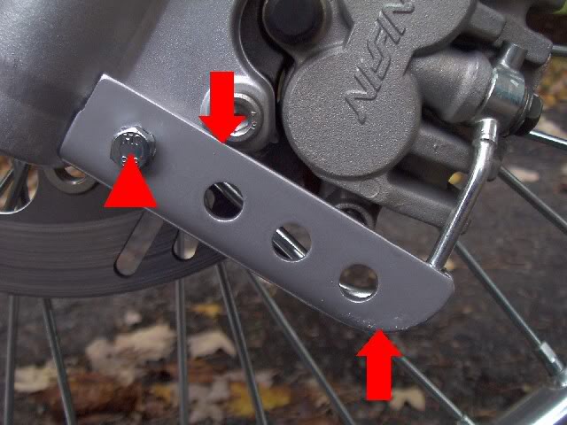

I'll take some measurements and draw up some kind of plans. I don't if there are any fab shops around Ottawa that will do small custom jobs like this, but at least it will get the ball rolling.
For anyone doing it themselves, I used 1" x 1" steel angle iron. I wouldn't suggest using aluminum, though, even if it's easier to work with. The reason is the bottom guard is a 3rd class lever betweenit's mounting bolt and the brake mounting bolt - aluminum would buckle much more easily if the bottom of the bracket was hit by a rock, even without the holes.

Is there only one bolt holding the bottom guard? If so my concern is the ability of the bottom guard to ward off any impact. If it gets hit from the middle back from underneath won't it foldinto the brake line? Maybe I'm not seeing something.
Thanks again.

Yep, there's only 1 bolt holding the bracket in place. I wasconcerned about thattoo, so that's why I made sure the bracket butted up against thehex boltholding the bottom of the brake caliper. A better design would be to use both bolts to mount it, but this is the best I could do using just a piece of angle iron.
Mike
