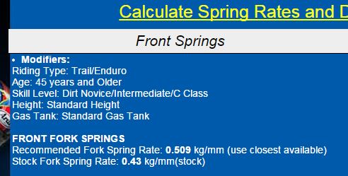

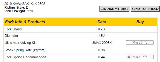

MotoPro and Ractech show different specs for a 2010 KLX250S and different recommended springs for my weight/riding.... What gives?
MotoPro says:
stock spring rate .38 kg/mm front, 5.5 kg/mm rear
for me .44 kg/mm and 6.0 kg/mm
Racetech says:
stock spring rate .43 kg/mm and 5.6 kg/mm
for me .51 kg/mm and 6.6 kg/mm
MotoPro says:
Racetech says:
Just curious, what riding style did you choose on the dropdowns?
Racetech's and MotoPro's suggested spring weight for me used to vary (.44 vs .46), but I think it depended on what riding style I selected. I'm sure if you're getting a lot of air you need stiffer springs.
Chose "Enduro" and "Trail/Enduro". Racetech skill level "Dirt novice". Just noticed MotoPro specs oil weight also.... Maybe Racetech specing diff oil? Noob issues here.
I'm even more of a newbie than you, but it seems like RaceTech's recommendation is better in this case. .44 seems too soft for 220 lbs rider from what I've read of other spring reviews (on this forum, thumpertalk, and advrider).
I'm around 180 lbs and was getting .42 - .46 as suggestions. I'll probably end up going with .46 so I have wiggle room with packing up bike, taking it on bigger jumps, etc.
