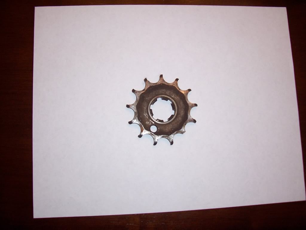

Default Free 13 tooth sprocket
First come first serveName:  sprocket.jpg

ha ha!!! Lots of luck giving that away.

Looks like the points are pointing a little south.

man.... how many miles are on it?

I dunno. The rear sprocketwas worse. The chain would bind when I backed the bike up.

Hey Mike, not trying to insult you or anything, but how much chain slack did you have? If its binding just rolling backwards, I think it was too tight. Can you get two fingers in between the chain and the swing arm?

I have 7400 miles on my bike and the sprockets look new still. Just curious.

I have 3300 and I my sprockets have like no wear. U gotta have slop in the chain. when ur riding at like 55-60 u should have enough slop that it gives a little so that u dont wear that thing out. lol

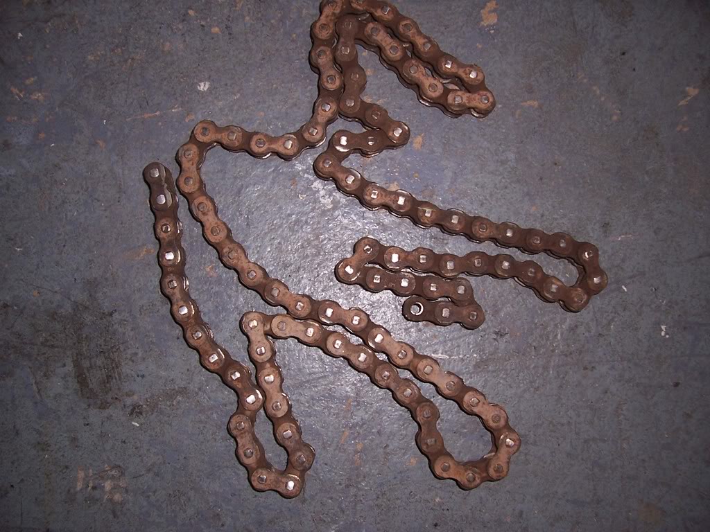

The chainseemed perpetually loose and flared out theteethon the sprocket real bad. The chain was also pretty stretched. I was constantly tightening the thing. It was froma KDX.
So... no takers on the sprocket huh? It'll fit the KLX.I'll also throw in a chain.Name:  chain.jpg
