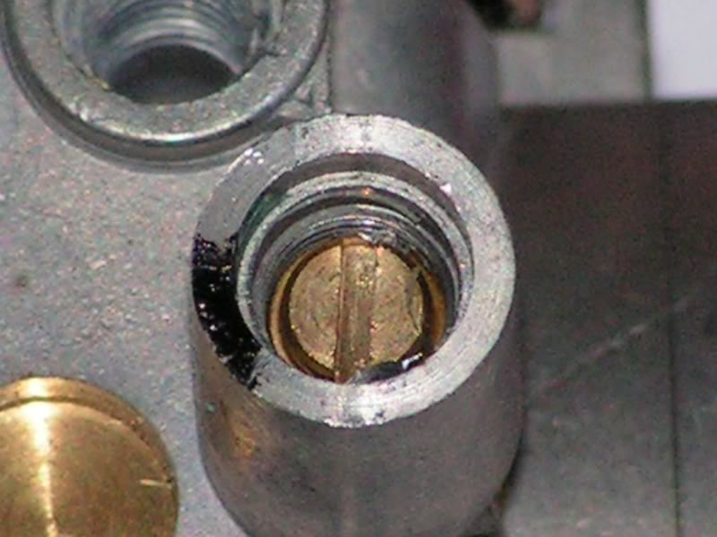

Lefty57,
As I read your post, I have to think that you probably have some pretty stale gasoline in that particular bike. I mean if you bought it with 650 miles on it and you've put 150 miles on all summer, I would think that the gasoline is probably 3 to 6 months old! If there was not any stabilizer in the gas, there is your problem.
To begin with, I would do this:
1, Drain the gas tank and refill with fresh gasoline.
2. Drain the gas in the lines by removing the screw on the carb bowl.
3. Get the bike started.
4. Add 4 ounces of Seafoam to the gasoline tank.
5. Take the bike on a ride to use all of the fresh gasoline.
6. Fill the tank back up with fresh gasoline, once again treated with Seafoam - 1 ounce per gallon.
The bike should now start easier. If not, I would now do this following:
1. Loosen the carburator clamps so the carb can be rotated.
2. Remove the screw that holds the throttle cable bracket to the carb.
3. Remove the throttle cables.
4. Turn the carb so the bottom of the carb can be seen.
5. If the bottom of your carburator does not look like this . . . . .
You will need to drill out the cover on the pilot jet adjustment screw and set it for 2 1/8 to 2 1/4 turns out. I have seen them completely closed. That will make your bike very hard to start.
Let me know how this works.
