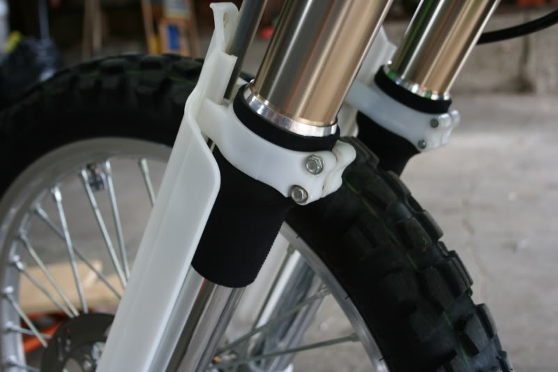

great idea!!! Do they make fork socks for inverted forks like these to minimize the dirt problem?

Those are Moose fork skins on my 07 KLX in the pic above.
Parts unlimited# 0406-0010 44-50mm standard
