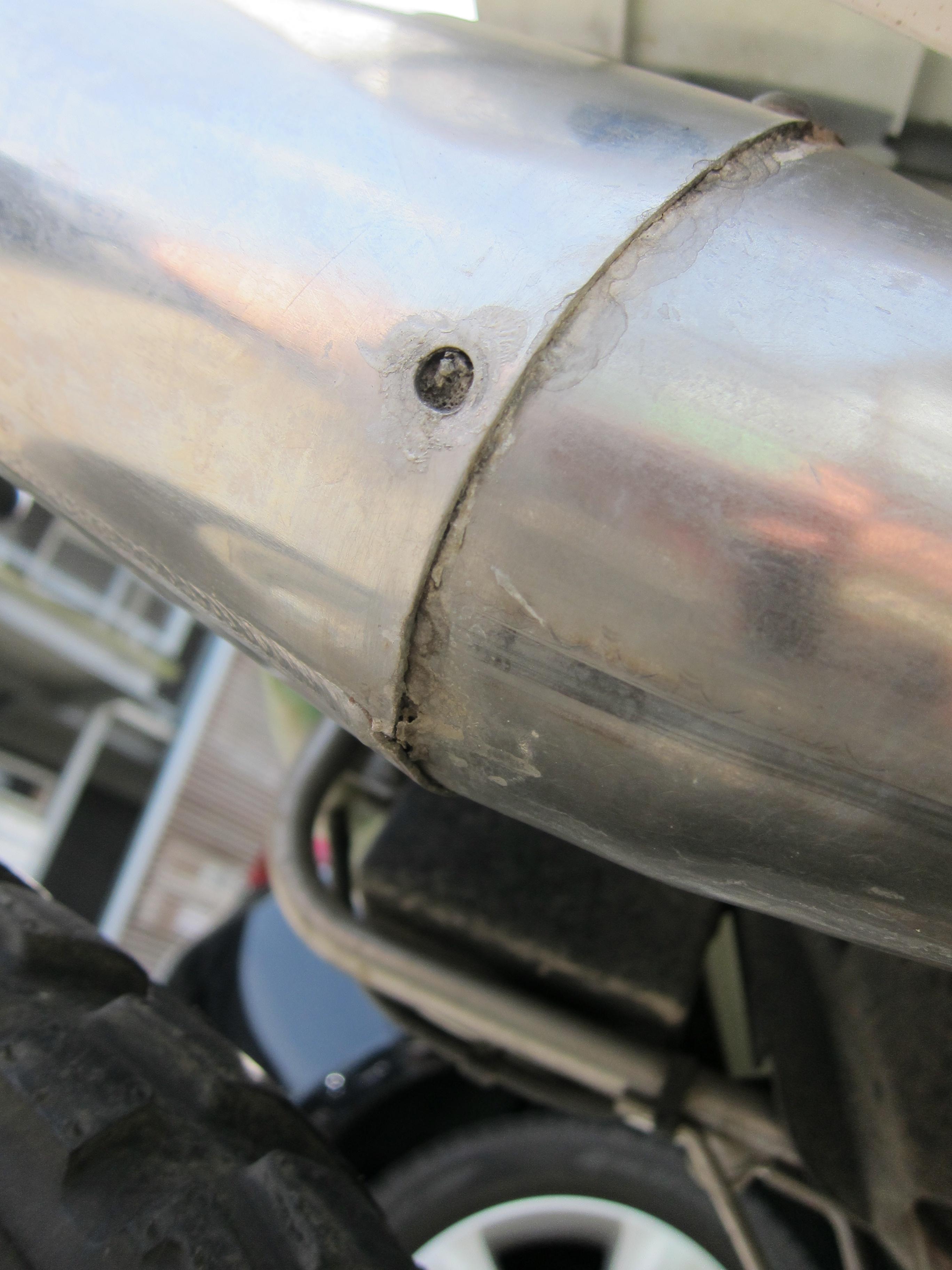

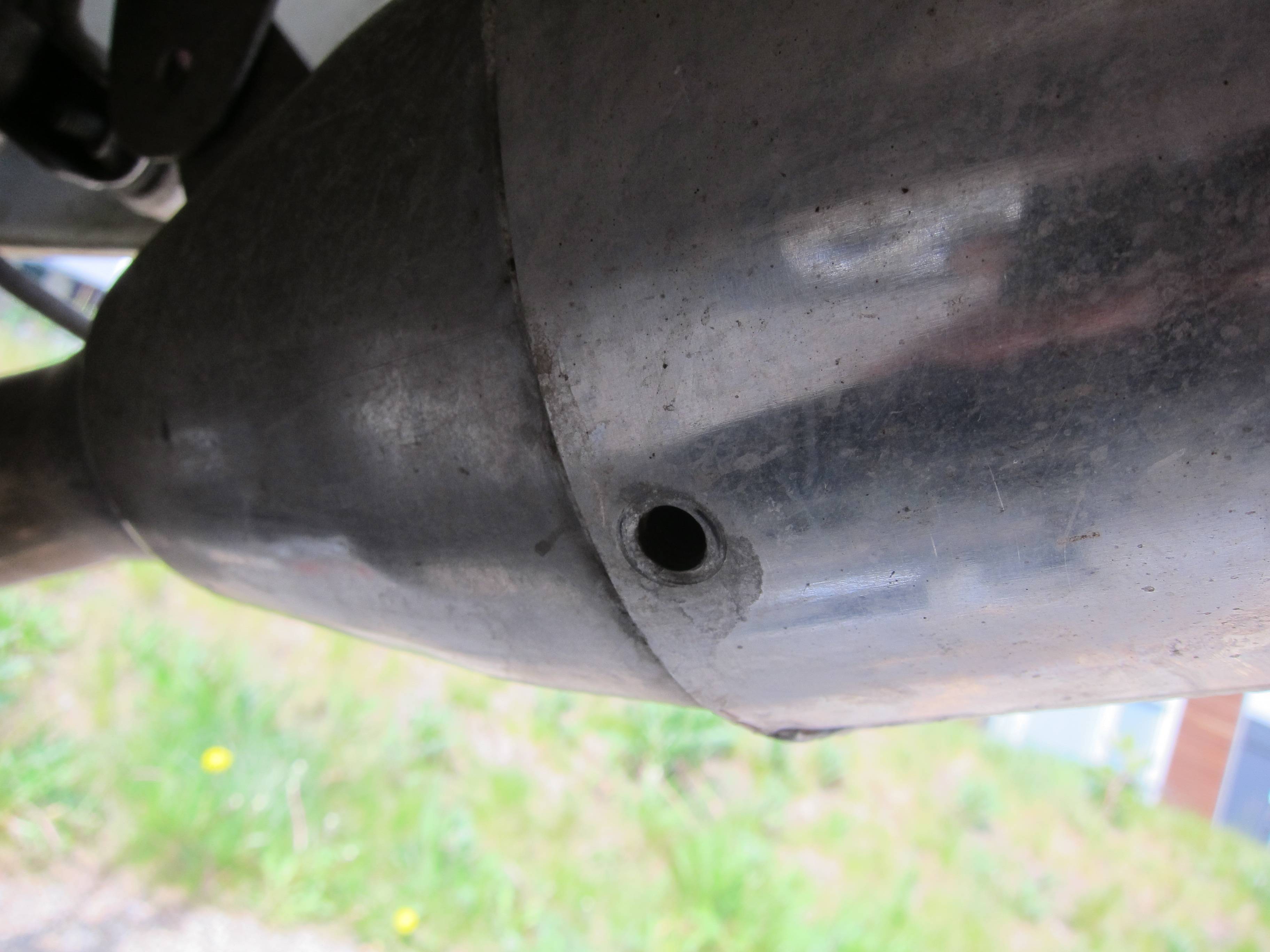

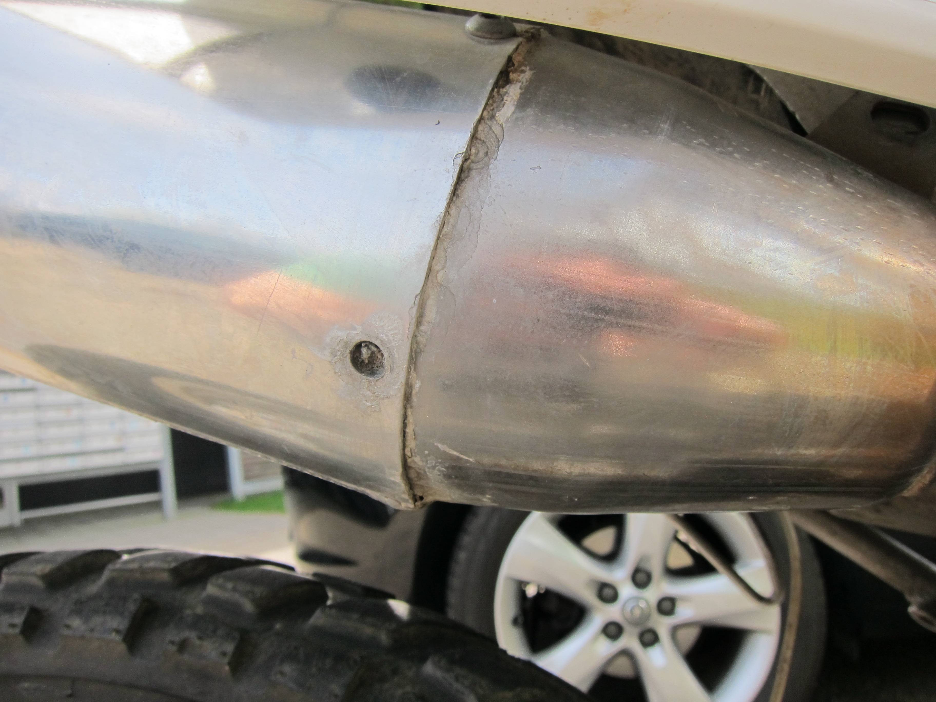

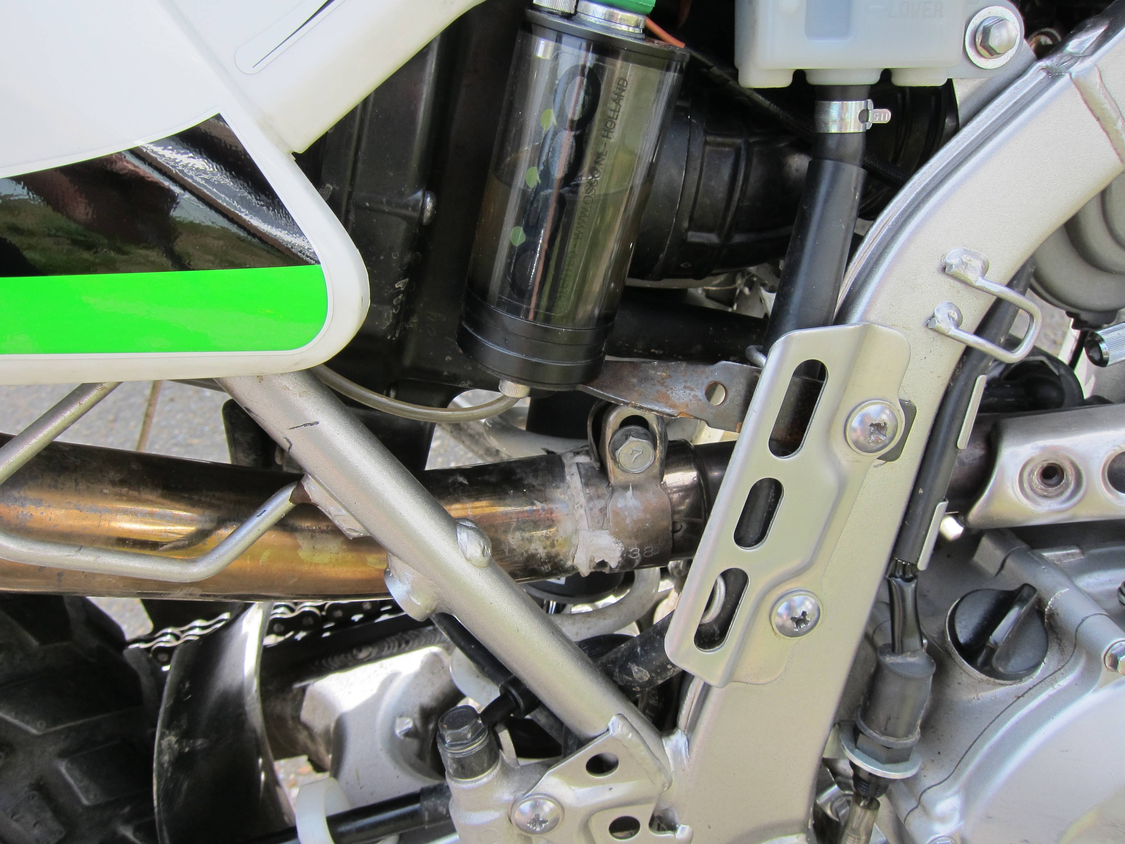

Anyway, here are some pictures as requested.
The white stuff the the sealant and you can also see two screws missing. The screws are almost the worst part of my problem. Any suggestions?
Note the forth pic also, its pretty much leaky all the way around.

I have an fmf header now but when I had the stock head pipe I used high temp black silicone and let it dry overnight and had no leaks. Used the same stuff when I went to the FMF header and had no issues, the silicone excess can be wiped off before it dries.

As for the stripped fasteners, get one thread size larger screws (self tapping if possible, otherwise drill the stripped thread and tap to the next size) drill out the can to clear the new fastener (the part being held to the cone), then put in the screws - carefully, don't strip it again. Maybe use button head socket screws (aka allen head).

Rivets? My pipe was riveted, seemed to work quite well.
Old May 4, 2014 | 01:25 PM
klx678's Avatar
Joined: Aug 2009
Posts: 4,650
From: Delaware, Ohio
Rivets will work, but if they start to loosen they cannot be tightened. They have to be drilled out to repack silencers too. That is why the screws were suggested... that and that's how both my pipes are built.
