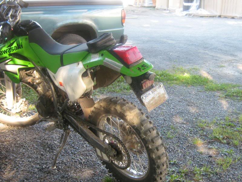

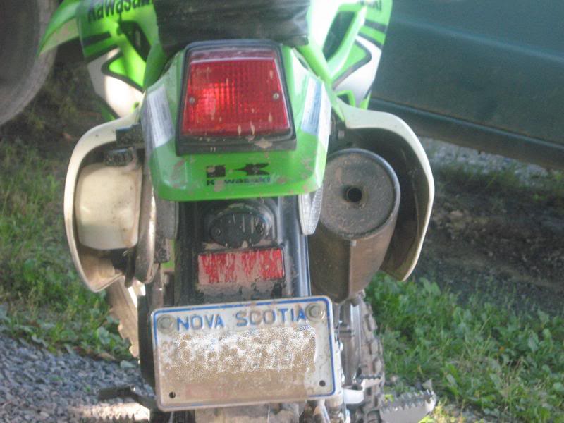

There ya go! My flushmount idea!
And just for fun.....
My bike in action

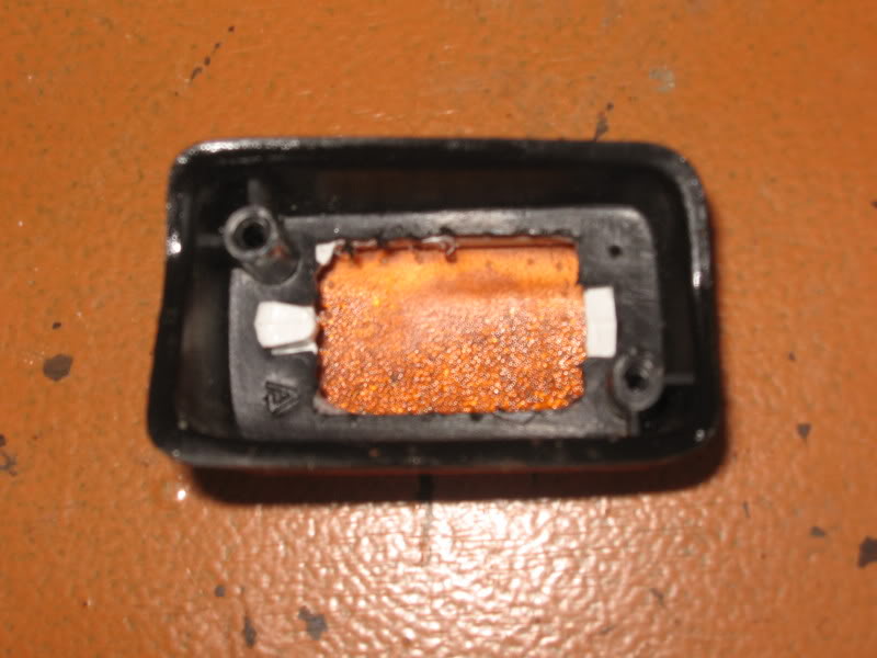

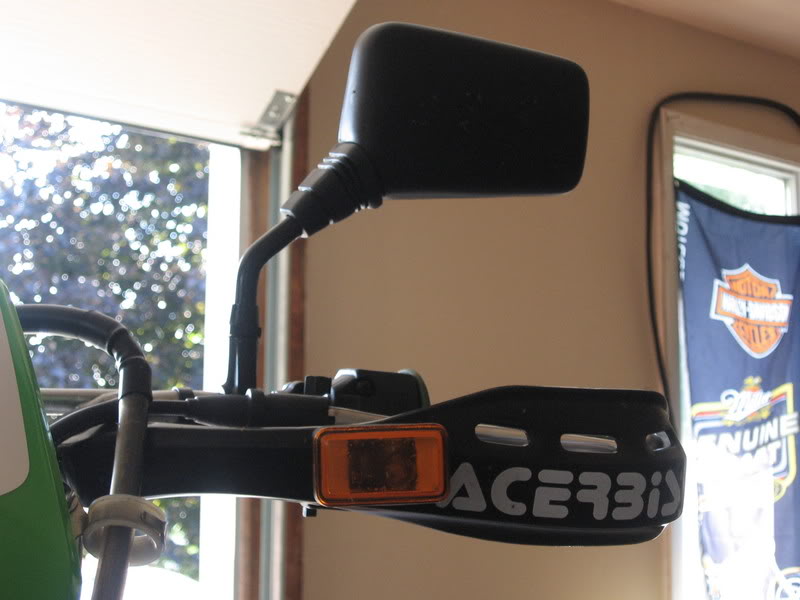

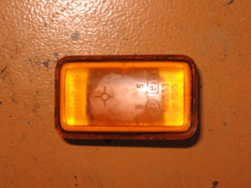

Okay okay..make me get up, get the camera, rip apart my signals just to post these..hopefully someone appreciates this..lol......

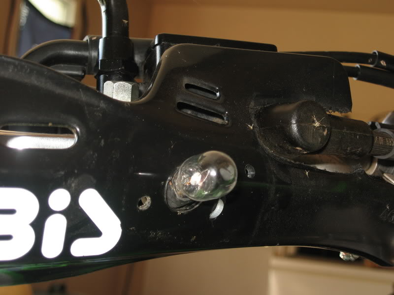

btw the bulb is a 921..18-watts, plenty bright

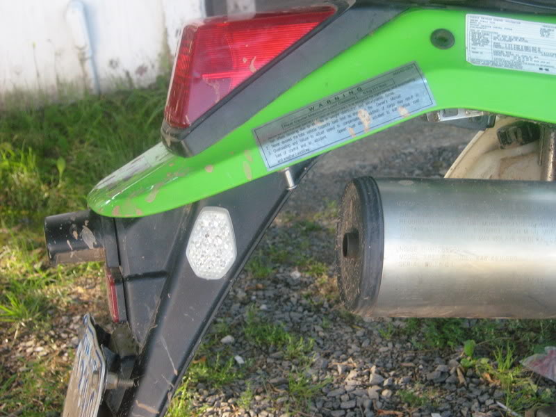

Yea well I bought one of these for the tail light.
What a joke!!! It ends up being 1/5 as bright as a stock 1157 filament bulb. Sometimes if it ain't broke, why fix it.

If you already have the acerbis handguards and signals, I recommend drilling or carving out the white plastic (as I did) and picking up a set of GE921 push-in 18-watt bulbs. And since you lose the tabs from the white plastic that hold it into the housing, I simply used a litlle waterproof glue to glueit back on..the bulbs will already fit through the black handguard itself, so no drilling required there..and since the bulbs are changed by pulling them out the rear of the handguard, gluing the lens on doesn't impede a bulb change. Also, I drilled a couple of holes in the handguard beneath the hidden under the lamp housing that I used to slide a pull-tie through to hold the bulbs in the hadguards so they won't fallout and dangle .
The halogens were really bright..but the price of ruining the handguards by the lamp melting everything to me wasn't worth it..the incandescent are the way to go..just my opinion....good luck, let me know what you find.
