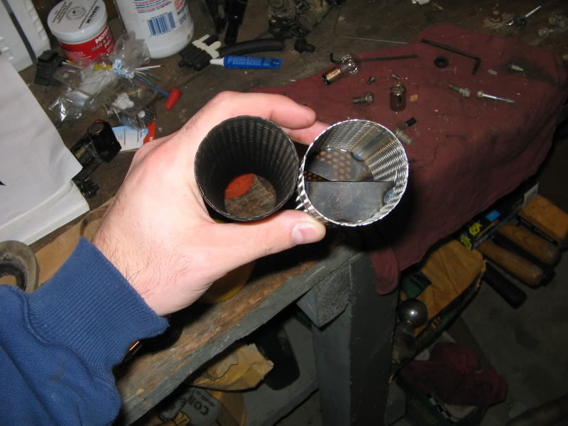

here is the quiet core

Oh, I know I'll need to repack, as I've already planned on it.
Question for you: Big Gun says there are two different lengths of baffles. 15 and 17 inch.
Which one did you use? (I take it you have the EVO X?)

yes i have the evo x.... do a search on dirtsurfers ordeal about ordering a quiet core, and there was another guy who had problems... but you have to give them exact dimensions of your existing core, which is (should be) the same as mine, its the 15" one, your best bet is to call and order it on the phone, you need to know how big the "bell" end is, diameter and length.

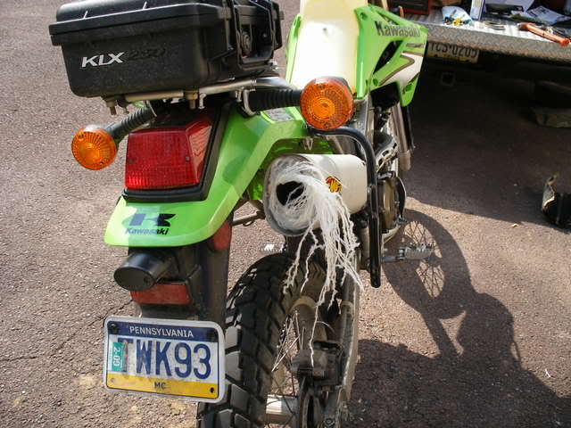

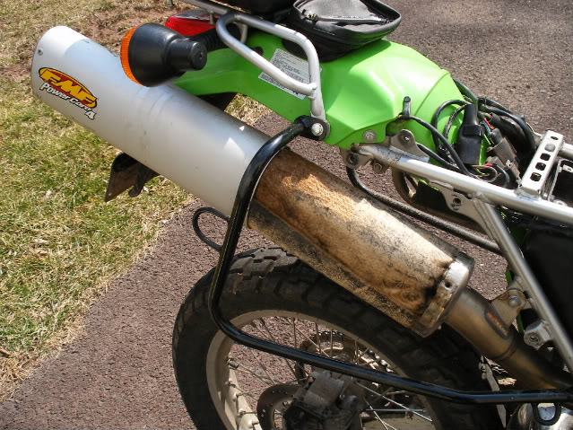

OK...I put my pics up...so here is my story of my FMF which is really easy looking to do compared to what you did...I was just cussing from the airborn fibers making me itchy...but otherwise only took me 20 minutes to do.
#1 remove 4 allen bolts from inlet side

slide off the can.....of course this is after you remove the 3 allen screws holding in the end cap cover,spark arrester and the quiet core.

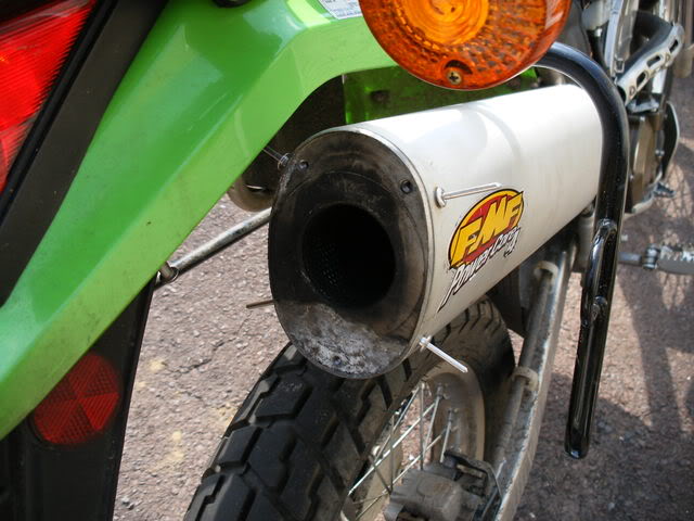

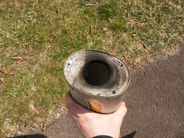

Drill out the 4 rivets holding the end insert into the can.

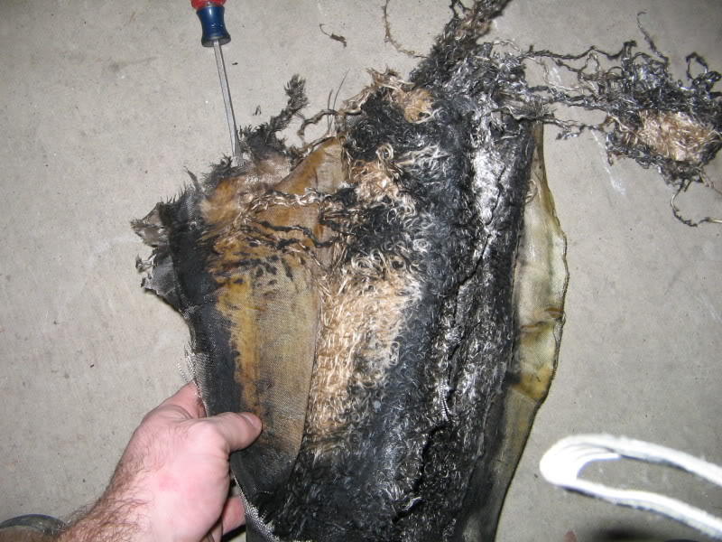

re-install the empty can onto the pipe.
after you unpeel the old packing and crap.NOTE pic is not in sequence but you get the idea.

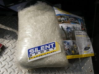

Grab a big bag of this stuff....Highly recommended from my local dealers guys that also ride SUMO and dual-sports....good power and keeps the noise down they say.

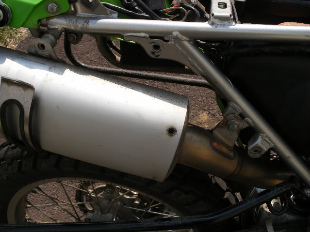

start packing away...not too loose and not too tight.....I used a loong screwdriver and my daughters ruler from her backpack....ssshhhhh... don't tell her ..LOL
the crap part.....
when you are packed to a T then you insert the end cover piece....FMF uses O-rings to seal it so it's easy.
The packing knocked the sound level down very good to where my air intake noise is alot louder from my seat than the exhaust.
The guys at the shop were correct....it works and works well.ok with me for 22$.....This is my input for the FMF.
NOTE: use a good high quality rivet for the end cap that does NOT pull the pin out of the rivet instead of breaking it off!!!! my first 3 rivets pulled the pins but the rivet was perfectly fine....I didn't think anything of it until i fired the steed up and exhaust blew out of the 3 damn holes without pins......drilled them out and slapped in 3 other higher quality rivets and all was good.

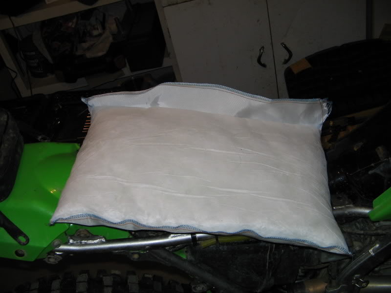

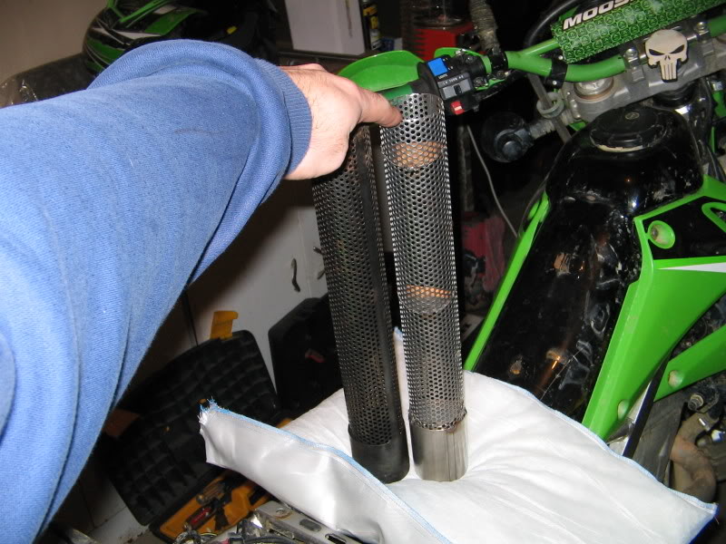

race tools repacking is in a "pillow" so i dont get covered at all.... just wrap that around the core then push it all in together.
but its a real **** to stuff it all in there.
