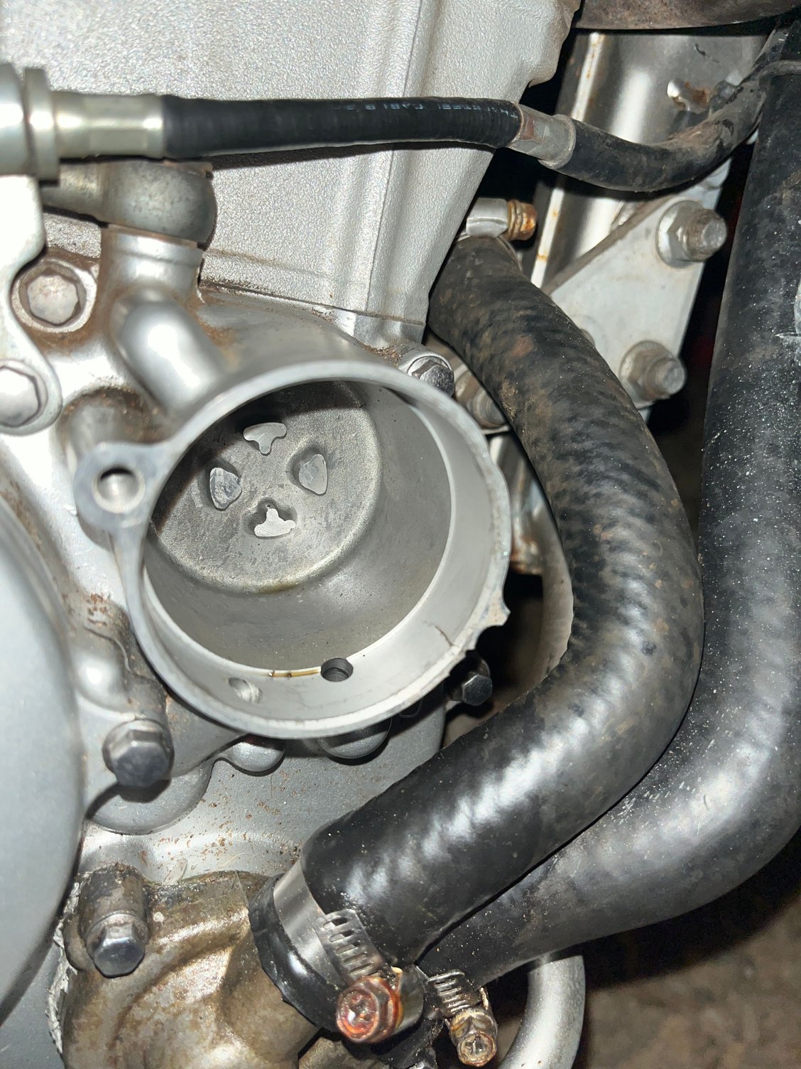

About the only thing that seems to come up over time is if the cam chain tensioner starts to fail. If it does there will be a rattling noise around 4000-6000 rpm. Gets worse over time. There is a chance the bike already may have a manual tensioner I make. Here's a picture of one so you can tell.
If the bike already has one here is a link to the installation, which has the adjustment techniques toward the end, should you need it. Click here
