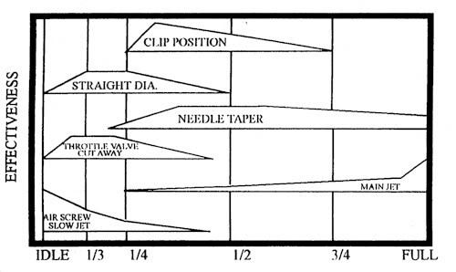

maybe its your pilot jet? what pilot jet do you have...... here is a image for reference....
