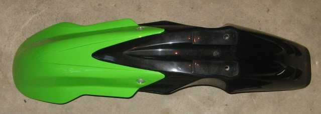

Finally able to install my newest goodie...

That looks great! I don't see the vents being a problem, the trajectory from the front wheel to the vents seems to have a well engineered angle that will prevent debris from passing through to the radiators. Good choice Eric!

Default RE: Finally able to install my newest goodie...
It looks so much better, the "lines" fit with rad shroud "lines"looks so much better, When drilling the holes dont follow thier directions, they give you a gride with letters and numbers and i tried to use that and then realized that it would have put the holes way to far forward. I just eyeballed it, lol, and saw where they needed to be, and put the old fender on top and drilled through the old fender into the new one so the holes were in the same place, and i used the stock metal grommets too.
