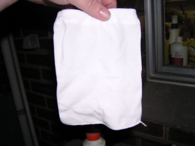

this is what they look like out of the packet

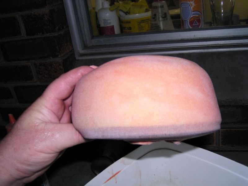

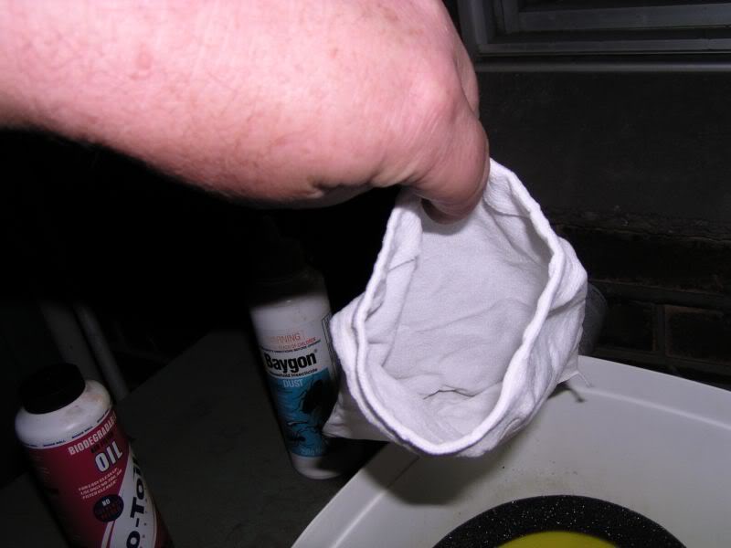

You oil the filter, put the filter over the cage then stretch the filter sock over the filter

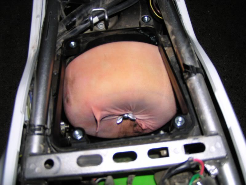

Put the filter back in the airbox. I thought afterwards it may have been better to put the sock over the wingnut instead of putting a hole in the sock for the bolt to go through?

The idea of the filter sox is so it is easy to replace the sox instead of always cleaning the filter, esp if on a multi day ride where you may clean your filter daily. You can buy filter sox "made for motorcycles" but these cost heaps more than the pool filter sox I bought from the pool shop. I bought 5 pool filter sox for the price of 1 "designed for bikes" filter sock.
Another thing I just thought of pulling the filter foam off that brass thing in the middle of the filter and maybe tearing the foam one day by using the filter sox you dont have to pull the foam off the cage therefore eliminating any risk of tearing the filter foam

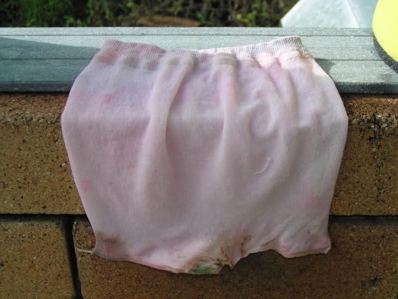

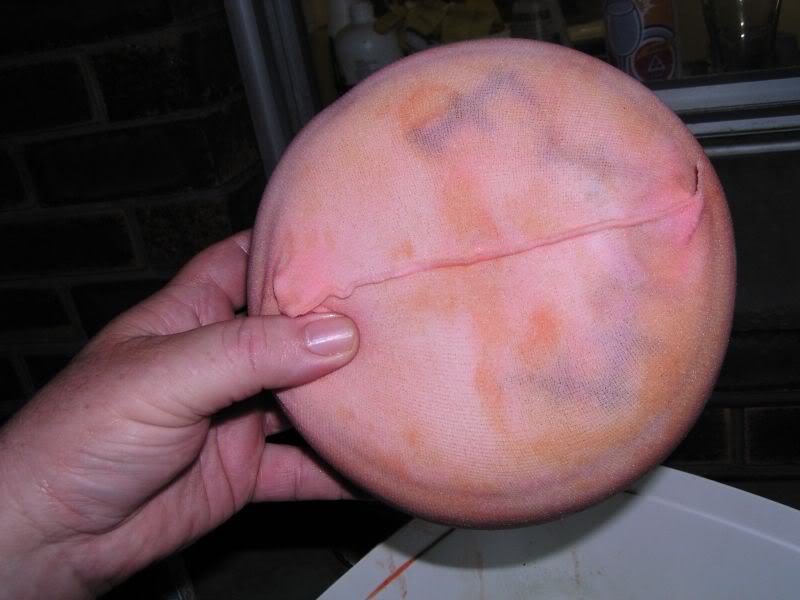

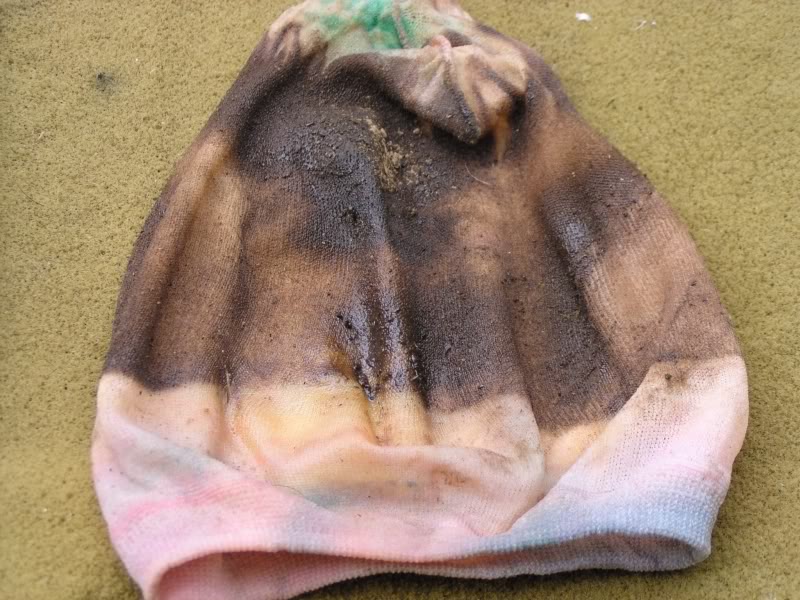

Well here it is 9 months later and I have finally checked my filter (yes I'm slack)
took the sock off

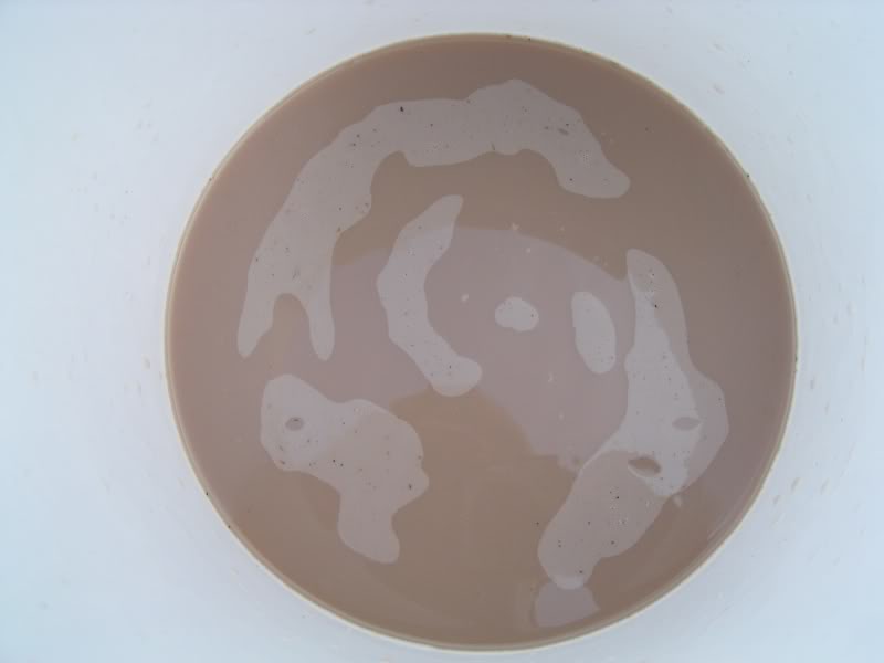

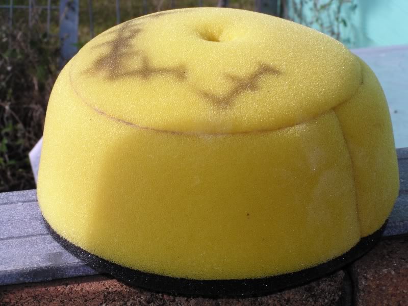

The dirtiest side of the filter

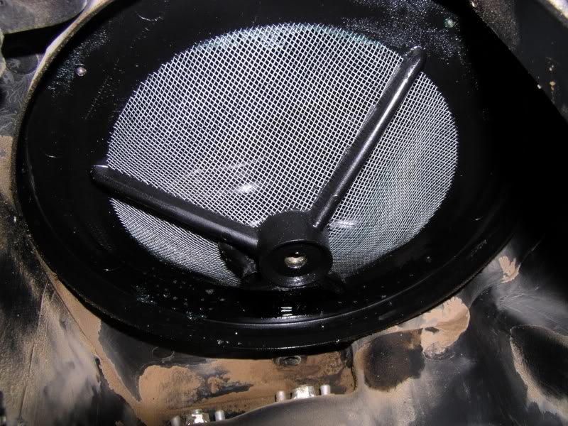

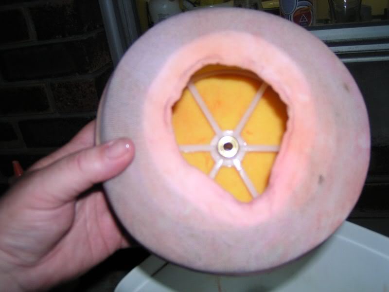

air filter mesh is clean

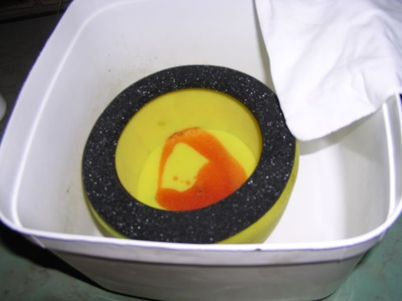

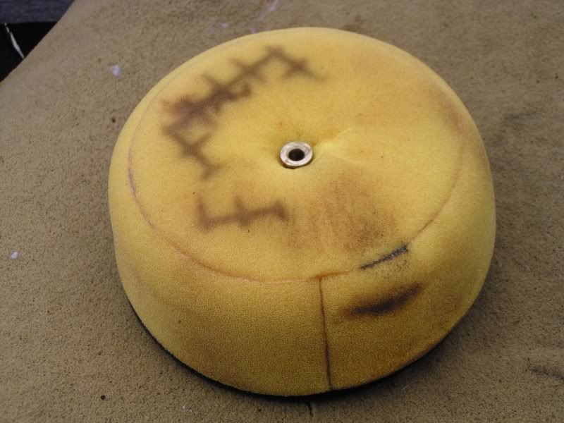

I took this pic after cleaning the filter to show the lack of crap in the filter the discolouration is due to the oil
after cleaning the sock
clean filter
I cleaned thesock even though I won't use it again
In conclusion I am very happy using the pool filter socks and will continue to use them
