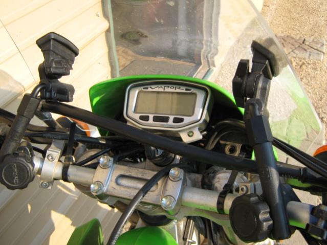

Sweet, should be a relatively easy install. Are you planning on keeping the stock headlight?
Old Jun 6, 2012 | 03:02 AM
TNC's Avatar
Posts: 5,050
From: Abilene, TX
Originally Posted by teamgreenrider91
its an 07 250s
The '06/'07 models won't need bar risers for the Vapor. Here's one on an '06.
Attached Thumbnails A few pics of my Trailtech Vapor install and more mods!-klx-new-3.jpg
Old Jun 6, 2012 | 03:05 AM
jhoffy22's Avatar
Joined: Jun 2011
Posts: 592
My only issue that really bothers me is the front brake line. When I'm sitting on the bike, my forks sag right in my line of sight with the screen of the vapor.

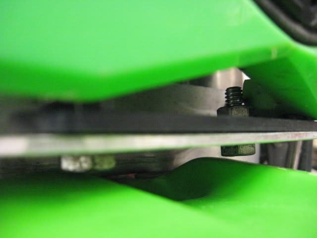

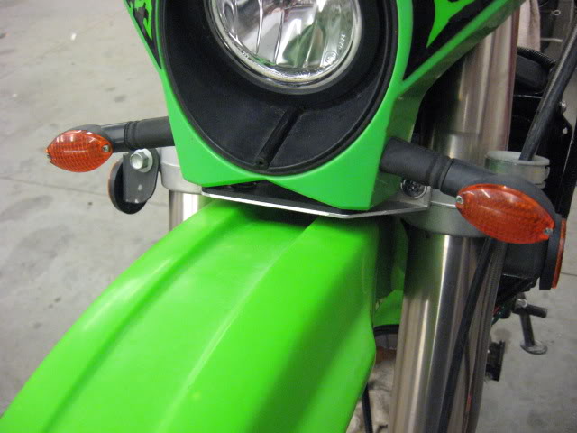

You may have seen already, but here's mine. Some more clean-up could be done to make it very inconspikuous...
No I didn't see that before, looks good though.
I would almost be tempted to try something like that if I had the dimensions
What material did you use?
Old Jun 6, 2012 | 01:09 PM
  #28
IDRIDR's Avatar
Posts: 4,507
From: SW Idaho
It's aluminum L bracket. Measure between the two fork mounting holes and go from there. Start with a piece of cardboard and mock one up.

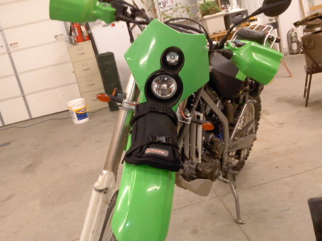

It's had a few iterations to get to where its at now. It started big and wide just to get something on there, then I whittled it down over a few shop sessions. I had to re-drill holes for the plastic X2 holding bracket to move it back because the headlight was pointing too far up in the air, especially when loaded down for a DS camping trip.
The headlight will mount right up to the fender on the 06/07, but I think 09+ is tougher. I wanted it higher up on the forks to shine over the top of the fender bag as much as possible. The bag still gets in the way a bit.
