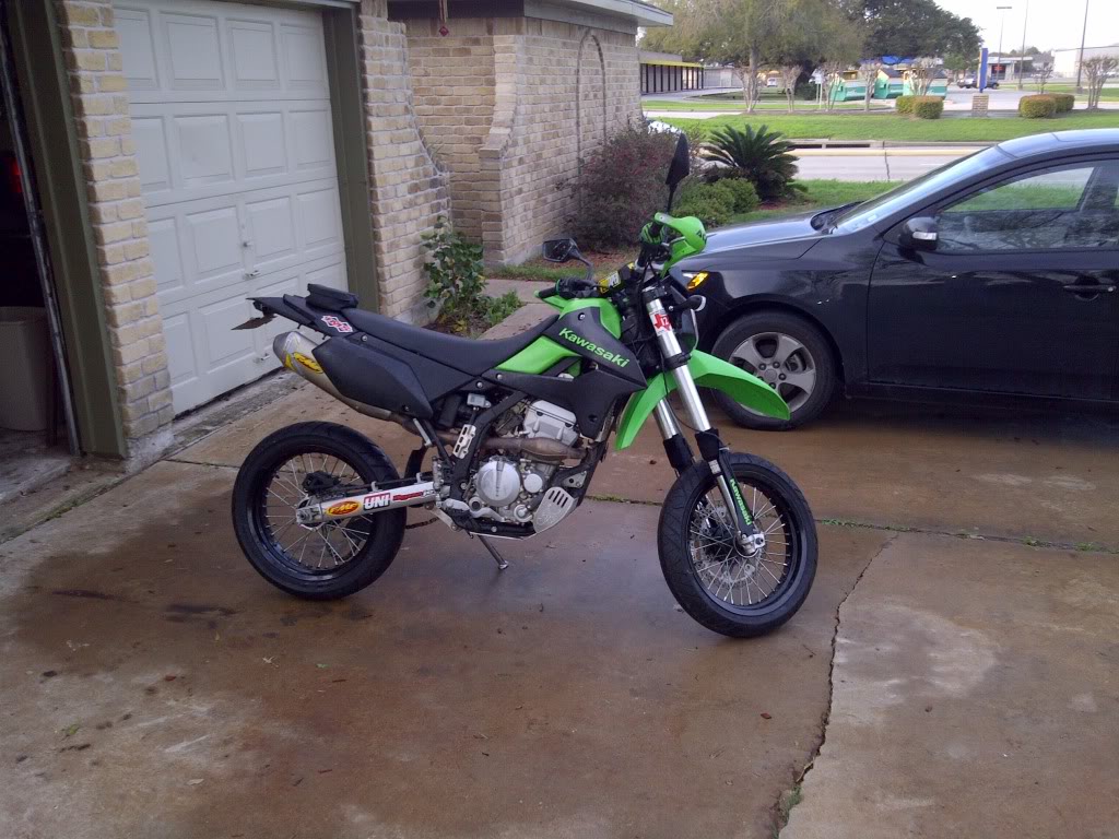

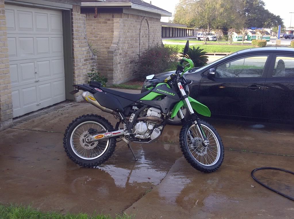

I have a set of both for mine. Running the s suspension and just end up swapping the chain, front caliper bracket and wheels. takes all of 20 minutes

I do have to tweak the rear rebound setting, compression is the same for both setups. And raise the forks a little with the SF wheels
