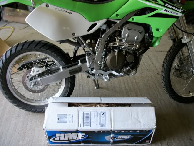

I've been busy upgrading my KLX. I bought an HMF exhaust, new jets for the carb, a Moose air filter, and another airbox lid. The lid was cheap and it came with the snorkel already removed. I thought it was worth $8 not to have the wrestling match with that stock snorkel.
For initial jetting I put in a 125 main, 38 pilot, and I shimmed the stock needle with a .025" brass washer from the hardware store (a standard KLR650 mod). I also drilled the hole in the slide out to 7/64" then put everything back together. No issues with the slide diaphram, it went right back into place. I fitted a Kouba fuel screw and set it at 2.0 turns out. That's just my best guess for jetting, but it's similar to what you guys are all running so I figure it should be in the ballpark. I hope I don't have to take that carb back off too many times. That is not fun.
And now the pics...
The patient ready for surgery:

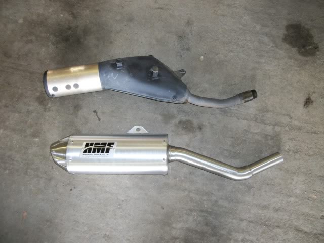

Old and new exhausts. 3 lbs of dead weight saved!

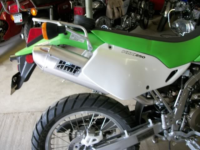

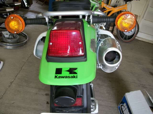

The new exhaust bolted right on with no issues. I think it looks a lot better too. I fired the bike up for a test ride and verified that it was running too lean, even before doing the airbox mods. It definitely flows more than the stock muffler. Has a nice bark too. I hope it won't be too loud for the forest rangers. I've got the quiet core and spark arrester installed so it should be ok. I think it looks and sounds great!

The business end:

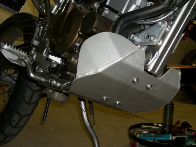

I did some other work too while I was in. I removed the air injection plumbing and plugged off the fittings, removed the cute but worthless stock skidpate and fitted a nice beefy Utah plate, and I checked the valve clearances. 8300 miles on the bike and it was overdue (PO blew it off, knowing he was going to sell). All clearances were in spec and the plug looked good too, so I just put everything back together. The clearances were all near the lower end of the range, so they'll probably need adjusting next time. But for now they're good.
Big beefy skid plate:
It bolted right up too. I had one of these on my KLR650 but it didn't fit as good. I was very pleased that this one went right on.

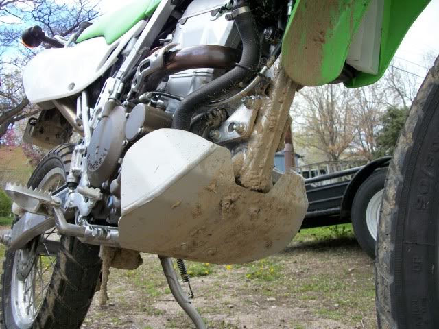

First Dirt!

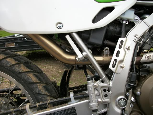

I went out for a test ride and decided to head over to Lefthand Canyon to see if they were still doing sound testing. I was too late, the Forest Strangers were gone, so I went on in and did some dirt riding. First real dirt on this bike.
It's running good! No need to go back into the carb for now, which makes me happy. Idle speed seems a little inconsistent when hot, so I might play with the fuel screw a bit. Otherwise all good. I had intended to fit a KLX300 needle, but I lost the clip. It slipped out of my fingers, hit the floor and disappeared. I could not find it back. So I had to order a new one (actually I ordered two so I'd have a spare) but they had not arrived on Friday when I checked. Parts guy said maybe Tuesday. I wanted to ride this weekend so I shimmed the stock needle with a brass #4 washer from the hardware store. I had some left over from rejetting the KLR650 that I used to own. That actually seems to be pretty good. I might not bother with the new needle for now.
I rode up to an area called "Five Points" where the trail splits five ways. It's a jeep road, whooped out a bit in places, rocky in places, and there was some mud today. Usually it's dry as a bone. The trail gets really knarly beyond Five Points so I turned around there and went back down. The bike handled everything great! I'm impressed. Even the Distanzias worked well, and they're really intended more for street riding. Traction conditions were pretty near perfect today though, with all the rain we've had. This bike is so much better in the dirt than the big pig KLR it's not even funny.
Definitely more top end than it used to have. It was keeping up with traffic easily on the highway and I hit a GPS top speed of 81 mph. That was going down a little hill though.
I checked things over when I got back and all looks good. The midpipe has already changed color to a nice golden tan:
