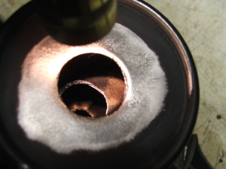

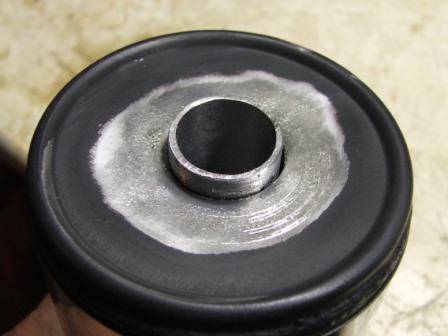

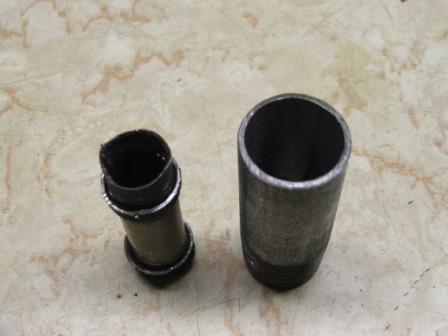

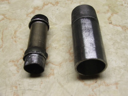

here is mne during construction a few years back.............
Attached Thumbnails Exhaust power tip-dscf1784.jpg   Exhaust power tip-dscf1786.jpg   Exhaust power tip-dscf1789.jpg   Exhaust power tip-dscf1787.jpg

I would find it hard to believe a simple tail insert could lay claim to power gain like a full exhaust. That's blowing some serious smoke now. There is no way it will improve breathing like a larger diameter aftermarket head pipe can. I bet he has no dyno charts from anything to prove that claim. It's just more bling that might allow a tad more flow, but not aftermarket pipe levels of flow.

Both DJFields and I doubled the out let size of the exhaust. We went from ID 15 mm to 20 and 25mm.
Its 30 mm where it comes off the head.
If I have it right,, the KLX300 has a bolt on 15mm ID tip as standard. That power tip replaces it doing the same thing we did. The power tip Looks far better.
I will gladly give up part of a HP for some quiet. I was runninig it in my shop today Its barely louder than stock and my air is still clean, I retained the cat.
I wish I had an aftermarket exhaust to test on the dyno and compare.
David
