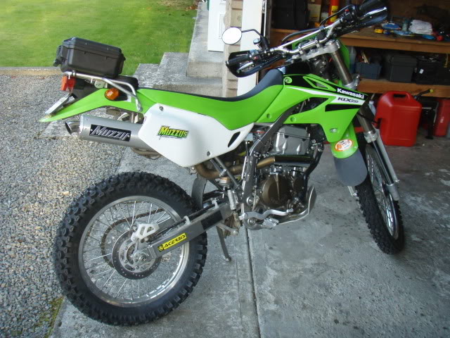

Just ride faster than the exhaust. Are you sure you don't have a leak? Here is mine with the Muzzy, as you can see its pointed somewhat down. I've never smelled like exhaust when I came home.
