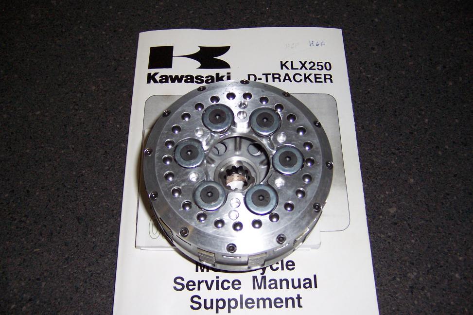

23 Jan 2010 Shipped complete KLX clutch and cover via UPS ($30.26)
1 Feb 2010 Clutch received at EFM.
8 Feb 2010 Shipped from EFM via UPS ($24.39) (Cost for clutch is $625.00)

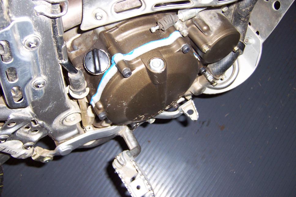

15 Feb 2010 Received from EFM - Clutch, spacer, gasket and cover with instructions and all KLX clutch parts not used. The clutch basket has been modified, there is no going back
without buying basket and parts from Kawasaki.
16 Feb 2010 Installation of clutch.
Clutch came back as a complete unit, slid it on the shaft with washer and nut. Done!!! Installed spacer using RTV silicone sealant as instructed, replaced gasket (from EFM) and clutch cover. Clutch release shaft has been removed from clutch cover and the hole has been plugged.
